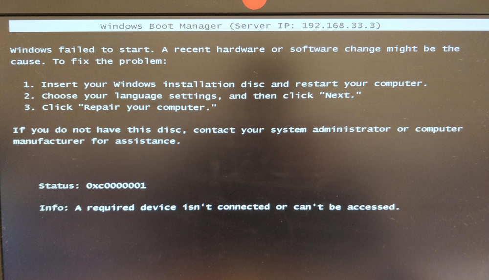

Got a bit of a strange issue and I know I've got it to work before so I'm getting a bit confused. I've disabled Secure Boot, Enabled CSM and Legacy Boot. But every time I PXE boot to MDT and select LiteTouch (x64) I get the following error message
MDT has all the drivers imported also so what on earth is going on? If anyone could help I'd really appreciate it, I don't want to loose any more hair than I already am!!
Thanks in advance :)

have you tried another boot image (just the standard boot.wim off a win10/server20xx dvd) as a test. i had a laptop yesterday (lenovo as it happens) that would bsd on bootup to mdt but would work fine with other images. in the end i created a new bare bones deployment share and it booted fine (driver conflict i think)
Well I've realised it's happening on every computer that tries to PXE boot now. I'm just now regenerating the boot image and I'll see if that helps!! Fingers crossed :|
One of the results I found on google with that error code said it started working again after restarting the WDS server, have you tried that?
Tried all the above guys but nothing unfortunately still the same. I can't work it out. I've regenerated the boot images and made sure to re-import the new one's created but still nothing. Tried using a Windows 10 disc and imported the boot image into WDS directly from there but still gives the same error when trying to boot from that and restarted the whole server but still after it's restarted having the same issue.
I really don't understand this, I've tried every boot image also the x86 and the Capture Image and all fail every time. It was working literally a week ago perfectly fine and nothings changed as far as I'm aware.

Nah not a DHCP server, I've some how fixed it, the only thing I changed was enable variable window extension tick box under TFTP and now it seems ok.. Strange. Thank you everybody though :)
