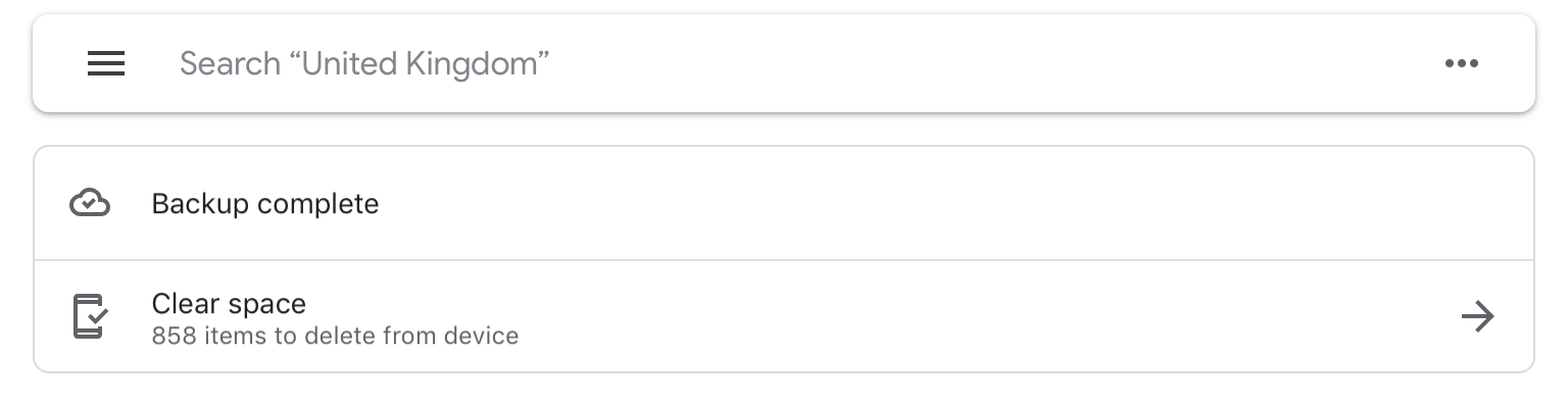

We are 1:1 iPad+GSuite with about 1k devices (granted, we avoided buying the bottom-tier storage option on them). Teachers and students are in charge of managing their own storage. We have Foldr so teachers can access files on legacy network shares, but everyone is encouraged to use Google Drive. We're constantly repeating "save it to Drive," etc.. Everyone is taught to enable auto-backup on Google Photos. Where storage is an issue, the photos/videos can then be removed from the device without a problem -- Google Photos even encourages you to do it (see screenshot).

I also make sure teachers lower the quality settings for video recording -- nobody needs 4k HDR video of little Susie's poster presentation, and 720p/30Hz saves a ton of space over 1080/60 or 4k/anything. The other advantage of Google Photos is that it's automatic, so when teachers need to send a photo to someone or use it for something, it's already right there in their Google Drive - no need to wait forever while it uploads over their lousy home DSL as they prep for a lesson at 10pm the night before (not that anybody ever does that, of course!).
