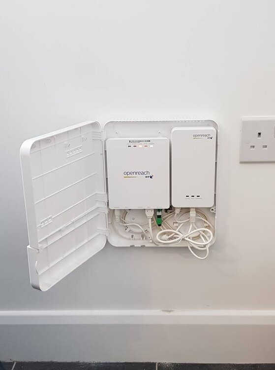

Picture of what BT Openreach actually install in your property is below. Note the box on the left is the Openreach modem which is also a VoIP ATA and the box on the right is a UPS to power the ATA in case of a power failure at the property and someone needs to make a 999 emergency call.
