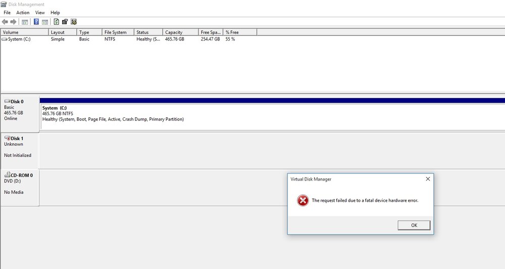

My personal external hard drive has stopped working.
when I go into Disk Management it comes up not initialized and when I try to initialize it it comes up with the error in the photo.
It appears in the 'Safely remove devices' and 'Devices and Printers'
Any ideas on how to fix it or is it dead?

Plug it into a Linux machine, see if you can mount it. If not I'm afraid it looks deceased. Good luck!
I second this! Linux isnt as fussy about mounting dodgy/faulty HDDs as Windows is so grab a Live linux ISO, boot from it and see if you can read any data from your HDD, if you can - then copy the data to another drive ASAP.

Tried two Linux live cd versions and the HDD is causing issues booting into the live disc.
If I dont have the HDD connected at boot they work fine but then plugging in the HDD it doesnt detect it :/

Definitely sounds dead to me so you'll just have to get the data from the last backup of it you did...
