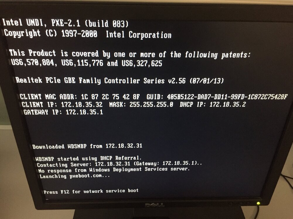

LytchettNM Posted June 28, 2017 Report Posted June 28, 2017 As I'm sure you have realised this picture show the client trying to PXE boot from 172.18.32.31 using it gateway of 172.18.35.1 so the client and server are on different subnets, and that the server has not replied. If you have a route from the server subnet to the client subnet then the issue is with the server at 172.18.32.31, if you have moved / setup a new WDS service have you enabled PXE and added a boot image?
newpersn Posted June 29, 2017 Author Report Posted June 29, 2017 Have you tried cycling the WDS services on your WDS server? Looks like server isn't listening Restarted the services and still no luck. As I'm sure you have realised this picture show the client trying to PXE boot from 172.18.32.31 using it gateway of 172.18.35.1 so the client and server are on different subnets, and that the server has not replied. If you have a route from the server subnet to the client subnet then the issue is with the server at 172.18.32.31, if you have moved / setup a new WDS service have you enabled PXE and added a boot image? Yep. I only moved the virtual server to a different host. The server still in tract. This worked fine last week before we was hit by ramsomware.

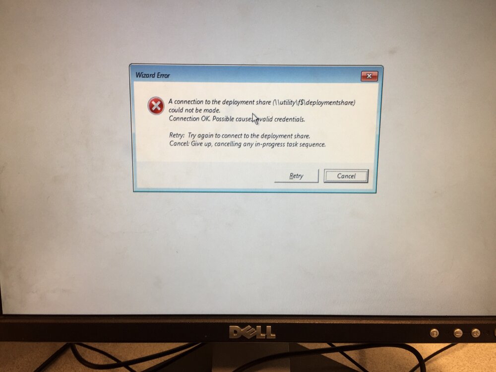

newpersn Posted June 29, 2017 Author Report Posted June 29, 2017 It's clean. Been scanned and checked. Just need to change the mdt user name and password as all passwords have been reset. [ATTACH]44219[/ATTACH] Anyone know where I can find it. Minds gone blank....
SHimmer45 Posted June 29, 2017 Report Posted June 29, 2017 the username and password for accessing the MDT share can be anything which has access to the share - if you are automating the connection to the deployment share remove that bit and attempt to do it manually (its the 1st part of the wizard when it boots MDT) check to make sure you can ping the IP and hostname of the MDT server just in case there is anything funny going on
sted Posted June 29, 2017 Report Posted June 29, 2017 Anyone know where I can find it. Minds gone blank.... the password its in deploymentshare\control bootstrap.ini and customsettings.ini if you change bootstrap.ini you will need to rebuild/reimport to wds your wim file for it to take effect 1
