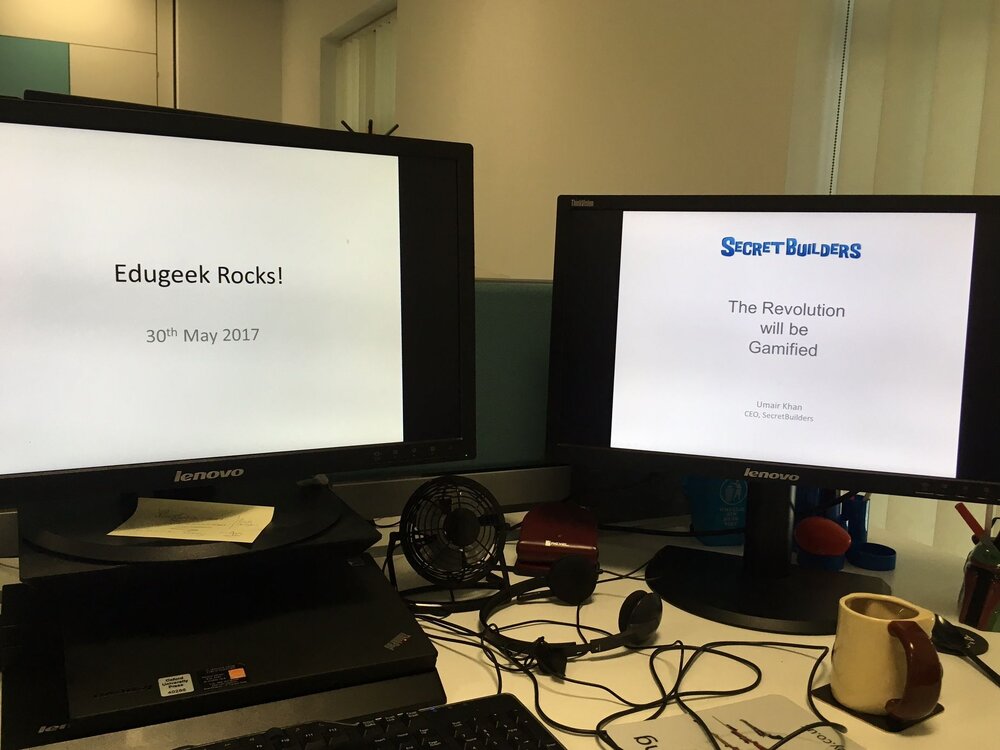

Problem solved. What you have to do is startup the PowerPoint as a slideshow *then* you can change the monitor for the second screen.
see post 8.
yes, it does seem daft that you have to mix the two types of display. Not sure fixing this will be top of the pile for Microsoft.
