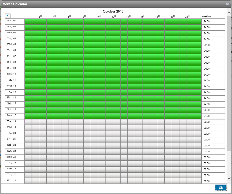

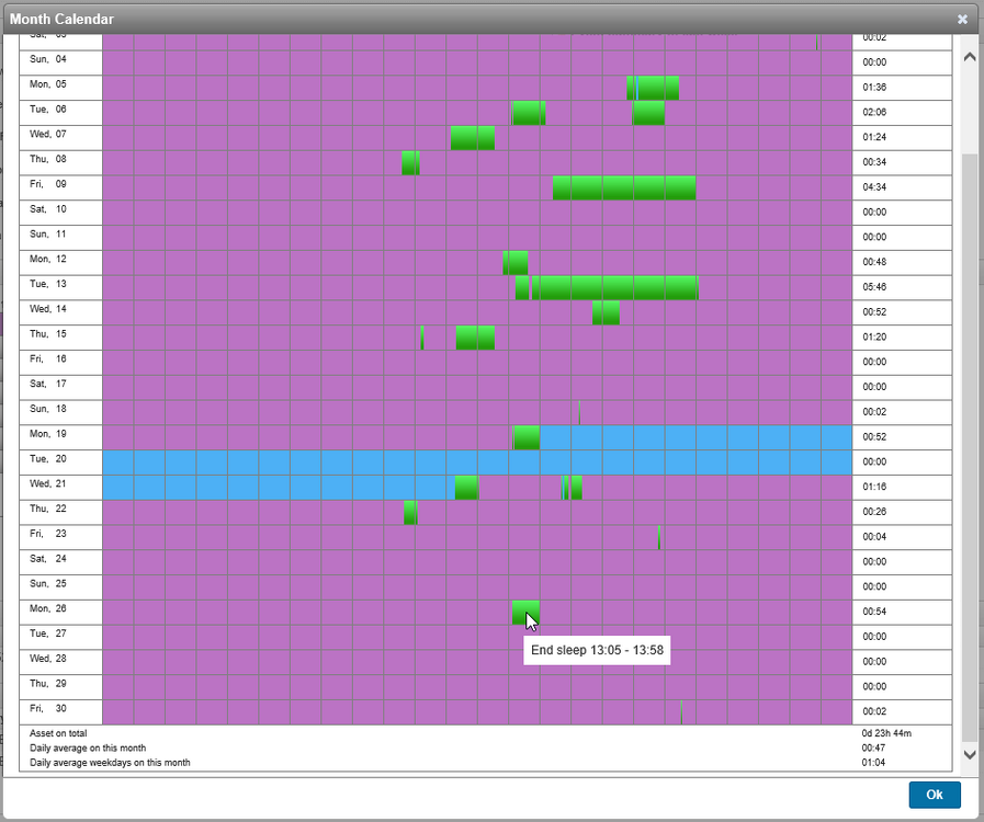

Lansweeper has a power on / sleep / off reportPC On.png that may help. Purple is sleeping, Green is on, Blue is off (it fills it in once its back on).
Thanks John although I should have specified it really needs to show logons as the computers in these rooms mostly stay on. I guess I could always make them go to sleep though, good idea

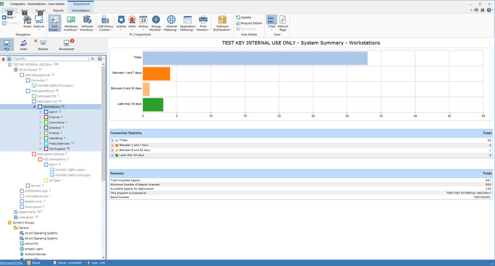

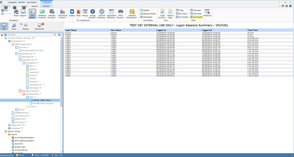

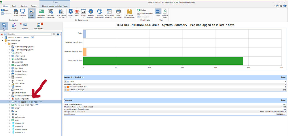

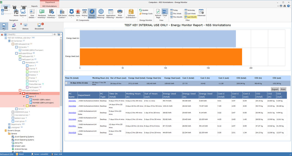

@Al_NetSupport does NetSupport have anything like this that we could use if we move from Impero?
Hi and thanks for the question. We don't have a feature that is identical, but yes, we absolutely do have lots of views for monitoring computer use. So we have things like dynamic groups in our tree view and one of these is for PCs that haven't been used for X days so you can spot kit better deployed elsewhere. Then in our Energy Monitoring module ( part of our power management) we have views for departments and individual PCs showing when someone logged in and out, when the PC was on and off etc.
I'll be honest, its more detailed and textual than simple and graphical and i quite like the Lansweeper approach. Will look to review for our next updates :)
Hope that helps
Al.
Edited by Al_NetSupport
added scressnshots
