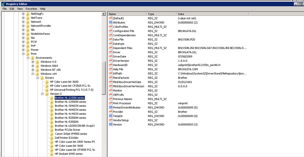

None of my printers in the registry have a PrinterDriverAttributes key. Can this just be created with a value of 5?
Thanks.
You sure? All of mine have got it?
Yeah. Here we are.
[ATTACH=CONFIG]38978[/ATTACH]
