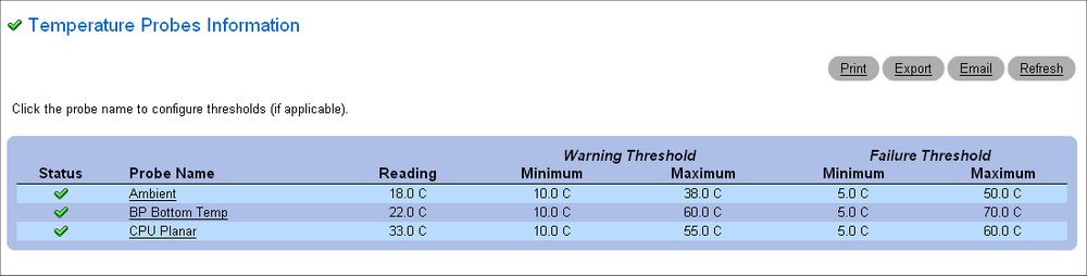

I'd say the CPU is overheating not sure why the clients would lock up unless it's a thin client network or RM ;)

Hmm, I doubt it's overheating, the server's in an air conditioned room kept at around 18C.

I've run a few basic tests using Dells OpenManage and it's come up with nothing wrong on the hardware side. Gonne get the UBCD out at lunch time and give it a going over.
