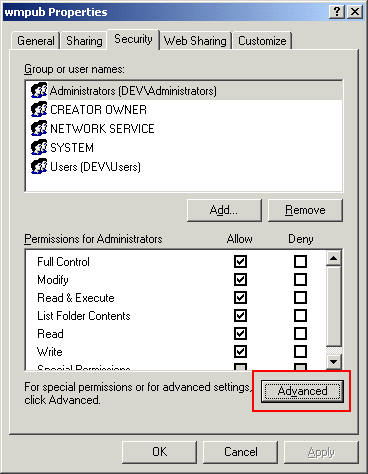

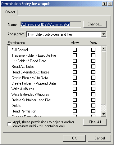

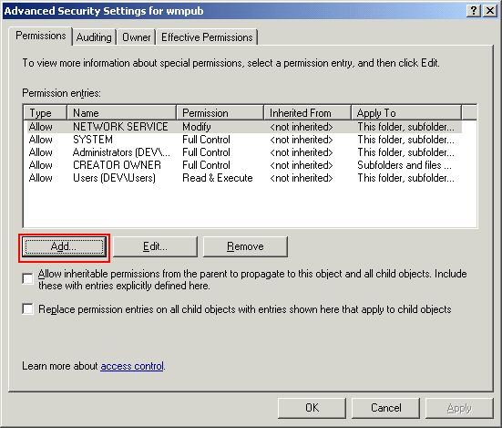

Yes it is possible, you are looking for the advanced button area on the security tab of the folder in question on your server [img1]. From there you can simply click the Add button [img3] to add special permissions that should allow you to implement the required restrictions [img2].
Head of art:
Allow
  • Full Control
Students:
Allow
  • List folder
  • Read Attributes
  • Create files
  • Read permitions
Deny - (probably not necessary depending on existing rights
  • assignment but it prevents it just in case)
  • delete
  • delete subfolders
  • create folders

In addition to what SYNACK said I think you'll find that you need to either remove the creator owner group or give that group read only otherwise students will have full control over files that they create.
I Wouldn't give the students DENY rights to delete, just dont give them allow rights, that way you can give delete rights to the group "creator owner" and then they should be able to delete their own work but not anyone else's :)
