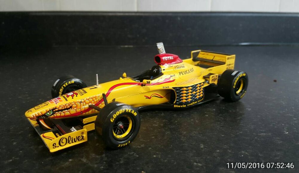

And the attached pic, also my profile pic is of the RB8 and the 2 MP4/25 McLarens

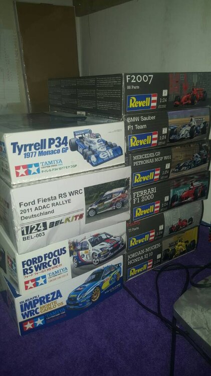

Ive got a scoobie, ford focus and a fiesta to do as rally cars. All the 1:24 scale. Ive got about 9 f1 cars to complete, mainly the revell sets and just bought a rare toyota f1 kit today off ebay. Its kinda become an addiction now :(.
