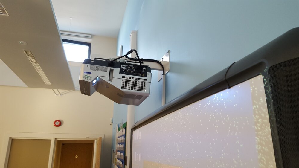

fiza Posted January 28, 2016 Posted January 28, 2016 Problem was not cured with a new bulb. Its a Sanyo but its not in my school but a primary down the road.
LeMarchand Posted January 28, 2016 Posted January 28, 2016 Most likely flecks of dust on one of the interior mirrors/lenses. I believe you can get people who will clean them, but as ours were out of warranty we bit the bullet and bought new (non-Sanyo) ones as this happened to every. single. one. I did try taking one apart for a look, but it was too fiddly for me. Managed to get a lot of it cleaned and it was better, but still not 100%. P.S. Impressed by the lack of rubbish stuck around the screen! 1
Kingstech Posted January 28, 2016 Posted January 28, 2016 That looks like a DLP chip fault. Generally they are a nightmare to change. Looks like it could be a replacement job. Might be an idea to contact Sanyo support. 1
mikeprice Posted January 28, 2016 Posted January 28, 2016 had a problem slightly like this at a previous school - started as a few spots but got worse day by day turned out to be one of the LCD screens inside the projector failing - not viable to fix so either replace or claim under guarantee I reckon 1
fredbayker Posted January 28, 2016 Posted January 28, 2016 I think they call it 'pixelisation'. As others have said it's usually cheaper to replace if not in warranty. 1
rad Posted January 28, 2016 Posted January 28, 2016 Happened to an NEC, we replaced it as it was as other had said cheaper to replace than fix. 1
timbo343 Posted January 28, 2016 Posted January 28, 2016 Oooh, youve got the "stars" problem. We have some NEC NP200 projectors that are doing this at the moment. I rang NEC a while back, they said it would cost +£500 to get it repaired as thr DLP chip has had it. We're finding that these projectors have been left on for long periods therefore we think the chip is overheating. We replaced a projector today and my tech gave the teacher the magic star clearer remote which will make the projector act like a brand new projector. Safe to say that i dont think the teacher has cottoned on to it been a new epson projector remote. 1
dapaulio Posted January 28, 2016 Posted January 28, 2016 Had that with my benq dlp projector and as others have said it's a fault with the dlp chip. Beyond economical repair. It's an option of make do or replace I'm afraid. Your only saving grace would be if it's still under warranty. 1
fiza Posted January 29, 2016 Author Posted January 29, 2016 Thanks all. The projector is not under any warranty. Have told school to order a replacement Epson.
timbo343 Posted January 29, 2016 Posted January 29, 2016 Thanks all. The projector is not under any warranty. Have told school to order a replacement Epson. Which one? The 585 or 580?
fiza Posted January 29, 2016 Author Posted January 29, 2016 Which one? The 585 or 580? They have opted for a 570 as they already have 1 of these.
