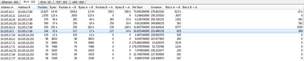

Wireshark:
Conversations view, IPv4, sort by packets:
Lots coming from an IP address that resolves to a computer which isn't even part of the network anymore (old isolation machine)
Second top is from the data server.
Fire away. Because I have no​ idea :(
UPDATE - found the PC, IP has been moved for an IP Camera. Took the IP camera off the network, was still flooding even though it wasn't plugged in???
See below, screenshot of the conversations view (top few anyway)
16.3 is the smoothwall box
Can we get a view of the packets it was sending? (if it continued after you unplugged it, then it wasn't the only thing on your network with that IP)

Conversations view (point 2 point) will only show back and forth connections, excluding things like broadcasts which are more likely to be traffic storming.
Look at endpoints (which will show broadcasts as a separate endpoint) and/or IO Graphs (for overview of amount of traffic going through the switch) also statistics - summary - avg packets/sec, avg packet size, bytes and avg bytes/sec.
I wouldn't be concerned with packet counts that low (the 1 highlighted 244 packets / 32k of data) even the top 1 with 15k packets /14mb i wouldn't be overly concerned about over that duration (176 sec / 3 minutes).
