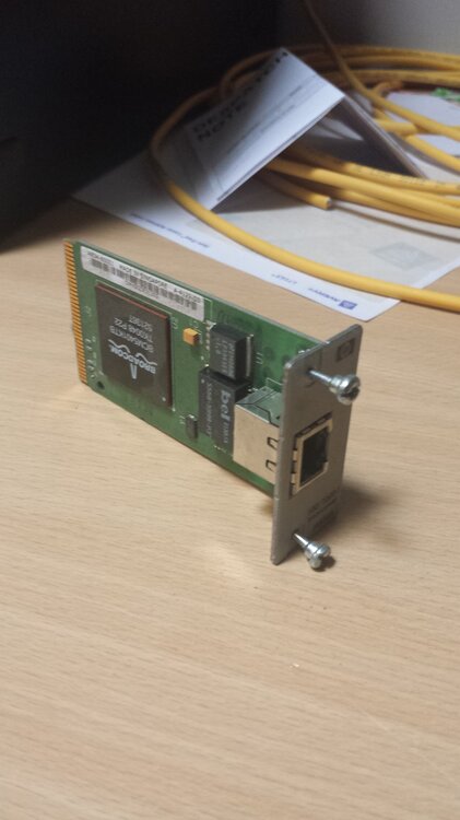

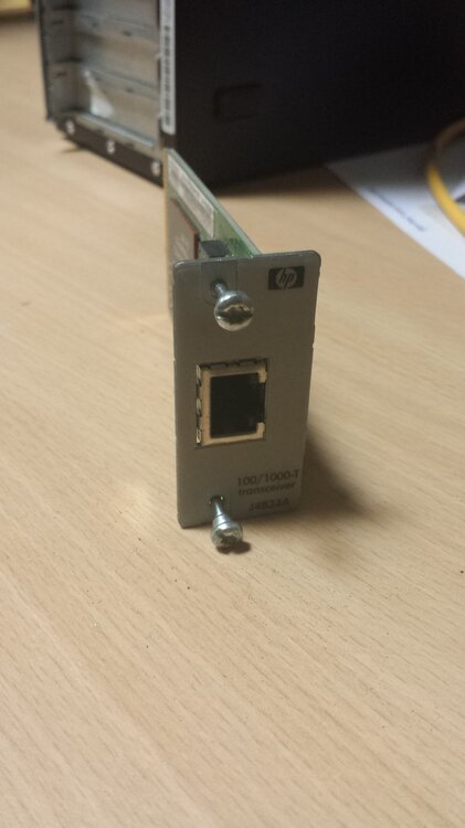

You have two choices really -
Either buy an LC to SC cable like this or replace the module with a 100/1000T module as illustrated above and link with Ethernet.
To be honest however, the money you're going to spend on cables/modules, a modern/basic HP Gigabit switch is probably going to be very comparable in price. I'm not sure the throughput on the 2524 would be 'true' Gigabit, despite advertising that it is connecting at this speed.
