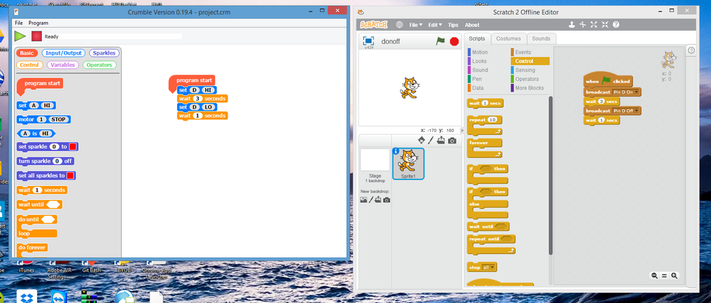

Just started down the route of a sort of cross-translator and managed to get it to convert a Scratch 2 .sb2 file into a Crumble .crm file
(an .sb2 file is a zip file containg a project.json file and a .crm is just an xml file)
Need to work on it being a bit more automagical but I think the same principle can be used for #Arduinos as well
Simon
