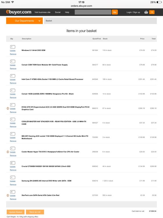

My sister has asked me to build her a new gaming pc. I used to do this a lot, but since having children 6 years ago haven't at all.
Does anyone fancy making some suggestions? She is a pretty serious gamer, and has given me an initial budget of £1500, but is flexible if there is good reason to go over.
Nothing from her current pc will come across, except the second monitor, keyboard and mouse, so will need a new main monitor.
My rough spec so far is:
i7 4790 (although slightly over the top for gaming, she also wants to broadcast games when playing so think its needed)
16gb ram
3 x 480gb ssd in raid 5
Gtx 970
28" 4k monitor.
windows 8
This brings it in a bit over budget, but think its a fairly rounded spec, but would welcome input, and any specific items.
Ideally she wants it as small as possible, so can take it on the train if necessary (gaming events etc) but not at the expense of spec / performance.
28" is max size for new monitor, would be happy with anything 24 - 28. I'm not set on building it, if an equal spec machine can be found ready made, but think it may be better value to build.
Thanks
Steve
Is RAID5 really necessary in a gaming PC? I can understand a RAID1/mirrored drive for redundancy but RAID5 seems like major overkill and with SSDs you're blowing a hell of a chunk of your budget on that extra drive, budget that could be used for a better monitor or additional GPU, something I personally feel would be of much more benefit in a gaming PC.
Just my 2p :)
EDIT: also, if it's going to be exclusively a Windows machine, seriously consider Storage Spaces over RAID - it's software based, but much easier to swap in/out drives and even move drives in to a new machine if necessary (hear horror stories of RAID cards dying and being unable to rebuild, even on an identical card/mobo. Also had an issue myself where a BIOS update killed my RAID without me realising for weeks!)

I like very responsive computers :-) But do see our point.
I like the idea of storage spaces though, I've never been too impressed with raid at the cheaper end of the scale and so this may well prove to be more reliable. Would have to have a separate boot drive then though, but think I have some spare 120gb solid states anyway, would be much easier to expand it in the future then if she runs out of space.

If you're looking at 4k gaming I'd pop a pair of 970's in there. Looking at the benchmarks and the reviews it seems that 4K is a push if you want fantastic framerates. I'd drop an SSD and rock with a pair of 970's in SLI
Raid 5 really isn't recommended for a gaming rig, would be much better off using Raid 1, and in this case storage solutions would be the best choice as mirroring through storage solutions delivers better performance than hardware raid.
I'm not overly keen on SLI configurations, they don't always work the best (unless things have changed?). The 4k monitor was more for future proofing, as monitors seem to last through 2 or 3 new pc's. She expects this to last 3 years before she'll buy a new pc.

SSD Boot (120-240gb) + 500GB or 1TB Hybrid Hard Drive. (or 2 if you want them raided)
This really isn't recommended either due to the slow loading times on the things that matter (the games).
My recommendation would be to avoid RAID entirely. Get a nice fast and large single SSD - if you're worried about resilience (that's all RAID 5 would give you, it's slooooooow) then add a big spinning disk for backups. Use the liberated cash to get a GTX 980 OC, or wait for AMD's R9 3** series cards.
The rest of your spec looks good. Make sure you partner it with a recent and decent Z97 board so it'll take Broadwell without hassle.
Don't use RAID5 for that setup you don't gain anything. If I was you I would put two 480/500/512 SSD's into a RAID0 config and then make sure you have a backup of any important data either to an external drive/NAS. If not just leave two SSDs as separate drives. In my home PC I have two 250GB SSDs in RAID0 (been running fine for nearly 2 years now) and then a 1TB spinning disk. It works nicely and its very fast.
Ok, raid is out - 5 too slow, and 0 too much change of having to re-build it, which would be down to me, and she lives 70 miles away.
I definitely want all ssd's. I'm likely to go with either 1 larger 1, or 2 or 3 smaller ones and use storage spaces, to allow for future expansion if needed.
Is a gtx 980 worth the extra over a 970? 970 seemed reasonable value to me.
Steve
Steve
970 seems to be the best value for me. I toyed with a 980 but couldn't justify it and settled on an msi970. I've yet to tax it massively either.
Monitor-wise why not look for something 1440p? I'm currently rocking one of these and it's great! BenQ GW2765HT LED IPS 27 -inch W Monitor 16:9 2560 x 1440, 1000:1, 20M:1, 4 ms GTG, DVI/DP1.2/HDMI1.4/speakers - Black & Glossy Black: Amazon.co.uk: Computers & Accessories
I've no issues with framerate and everything looks lovely! :)

that looks like a better value monitor to me, her eyesight isn't that great so cant image she'd be able to tell the difference between that and a 4k one anyway!
Steve
Might be worth looking at G-Sync monitors too - they're pricey, but paired with a 970 they're stunning (my limited understanding is it's hardware V-Sync - rather than limiting the framerate to match the monitor, the monitor matches it's frame rate to the GPU - flicker free image, minimal frame drop)
At 4K, the 970 will annoy you due to the 4GB/3.5GB bug, that's the res where it'll show up. Alternatively, stick an R9 295X2 in there so it'll have the power for 4K. Big money, but 4K gaming demands it unless you take a big drop in IQ settings.
I'm leaning towards a 1440p monitor now with smoother frame rates rather than 4k. new pc in 3 years time may be the time to go 4k.
Will look into the G-sync technology mentioned above.
Steve
