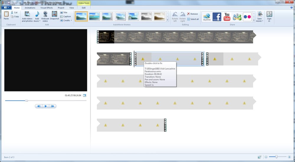

Mark182 Posted February 4, 2015 Posted February 4, 2015 Our IT classes are using Windows Live Movie Maker 2011 (build 15.4.3538.0513) Students grab videos from the shared area and save them in their home area (all videos are .WMV format) upload the work and save. Next time they open the project they saved they are met with a little yellow triangle (see picture) like it cannot locate the file. Any ideas?
synaesthesia Posted February 4, 2015 Posted February 4, 2015 I would be fairly sure from that, that they are moving the files after creating the project & dragging them in, assuming T: is your shared area.
Mark182 Posted February 4, 2015 Author Posted February 4, 2015 T is their home area. We tested it from our account and it did the same for us :/

Arreks Posted February 4, 2015 Posted February 4, 2015 Can you try it with the files stored locally to see if that works? if it does then it means that for whatever reason WMM can't find the networked files the second it opens - are your permissions set up on the document shares correctly? what happens if you close the project then re-open it, does it still have trouble finding the files? There is also this, while the error is not the same it could be worth looking into. 1
Mark182 Posted February 4, 2015 Author Posted February 4, 2015 Can you try it with the files stored locally to see if that works? if it does then it means that for whatever reason WMM can't find the networked files the second it opens - are your permissions set up on the document shares correctly? what happens if you close the project then re-open it, does it still have trouble finding the files? There is also this, while the error is not the same it could be worth looking into. Yeah, I'm guessing the permissions are set up right. As soon as you close it the videos disappear. It's always hit and miss what videos give the little triangle. Tried the Reg fix no joy :-/

LazyFanatic Posted February 4, 2015 Posted February 4, 2015 Sorry if I am stating the obvious, but when one creates a project and imports video footage to WLMM it doesn't actually bring the video in it just references the existing clip. So, until the project is completed and a WMV file is created the project and the video clips must both exist in the same place that they were when the project was created.
Mark182 Posted February 4, 2015 Author Posted February 4, 2015 Sorry if I am stating the obvious, but when one creates a project and imports video footage to WLMM it doesn't actually bring the video in it just references the existing clip. So, until the project is completed and a WMV file is created the project and the video clips must both exist in the same place that they were when the project was created. Yes, your right as the file size is only around 5/6kbs but when the try to export the finished project it cannot see/find the file even though its in the same folder. We even installed the newest version of movie maker but still the same outcome. I forgot we have Serif MoviePlus X3! So I will point the ICT teacher towards that.

ninjaguardsheep Posted April 27, 2015 Posted April 27, 2015 (edited) We had to create the key: HKEY_CURRENT_USER\Software\Microsoft\Windows Live\Movie Maker\AllowNetworkFiles as a DWORD with a value of 1 in our user profiles to get around this issue. Edit: Arreks beat me to it on page 1. Edited April 27, 2015 by ninjaguardsheep

ADMaster Posted April 27, 2015 Posted April 27, 2015 I'm late here but when our arts department had issues with movie maker, it was an offline files issue. I had offline files disabled by GPO for the entire school. Movie maker wanted offline files to be enabled. I don't recall now if this was WMM2011 or '12. This was back in Feb 2012 and they don't use it any more. Cheers
