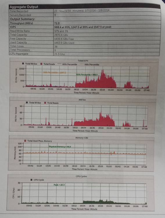

Our iops are a massive 300 :p when the system is in use. It shoots up to 1500 peak when backup exec runs.
Is this on the Dot Hill SAN? What disks does it use, how many, and what RAID level. That kind of performance seems pretty woeful for a SAN.
