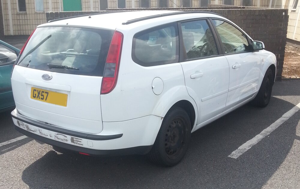

Yeyyyyyyy I'm finally on the road... here she is!
Focus CL Estate, 1.6, 86,665 on the clock, EX motability, Few little niggles which I need to sort - one of them being it needs A STEREO!!!!!
Cheap Tax, Cheap Insurance, Cheap to run.... No idea what the MPG is!

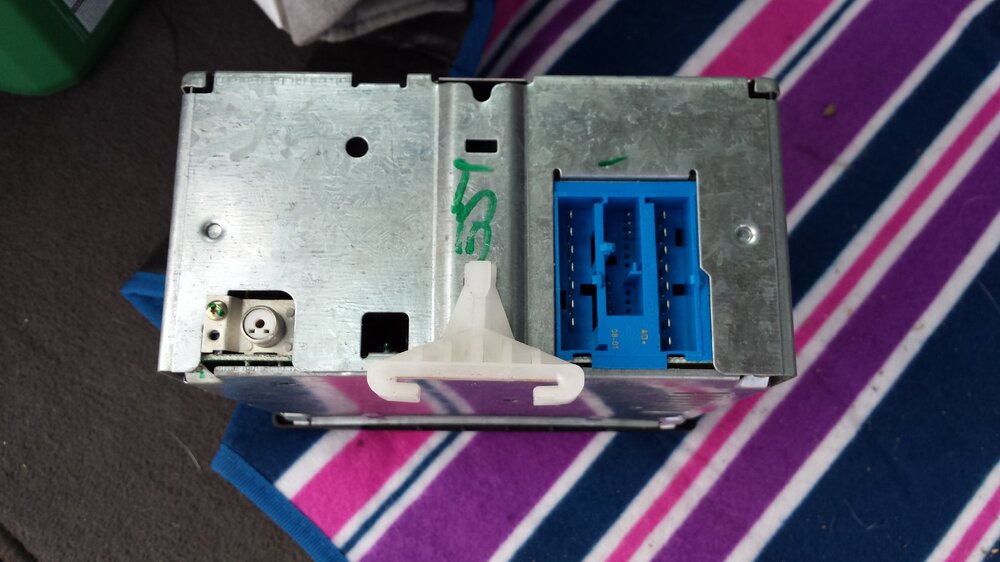

Mines got one with it that has a slot for what I imagine is a cassette slot lol, not that it works, and the radio doesnt tune in either so I think it's goosed... I had to crack the radio code for it too (I have all the codes for ford radios)... Mines one of these...

its basically the same but plays mp3 off cd as has an mp3 sticker on it. It was used in a few special editions iirc like the focus mp3. Might be a dodgy aerial or connection

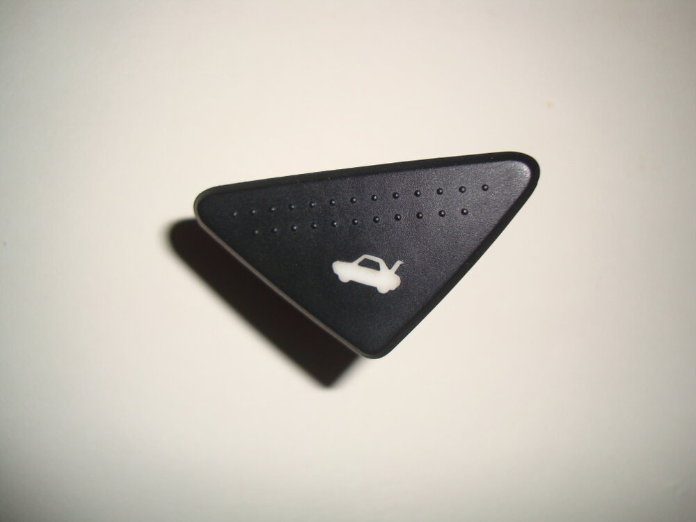

One of the problems I have and it's a right pain to be honest... Thew boot release button in the dash does nada! Not a bean!! No noises or anything when I press it. Anyone any ideas ?
I can open the tailgate with the key no problem.

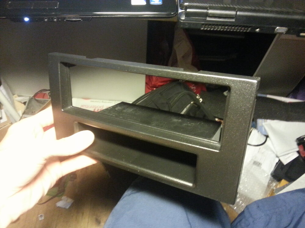

Ford do an adapter to fit a standard stereo in there, it's just a plastic trim, cost me £2.50 many moons ago.

The boot button could be a blown fuse or possibly the release solenoid is faulty or dodgy cabling. Time to crack out the multimeter
odds on the solenoid in the boot is dead or the wiring is faulty. Iirc failing tailgate release is fairly common on fords might be worth having a look on focusowners.com | for all Club Members ( I think that's the page but its been a while)

you will need adapters the ford stereos of this ager are not iso its a proprietry block
Cheers - I've been there to FOC... no replies. I might take the tailgate back apart at some point - I presume the solenoid will be behind the cover so will have a look at the weekend. Might nip into Euro car parts see how much it will cost for a new'un.
I thought this... Darn it.

I think that's where it is. I think this is just the mk4 fiesta but there aren't metal contact plates (looks like 4 or 5 copper strips) on the boot floor where the tailgate meets the inside if so get some meths and clean them

Ahhhh thanks but its boot release button... Like this one... DSC02813_zpse2c2fa82.jpg
