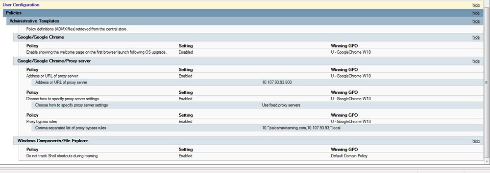

The only other setting relating to this that I have set is the following:
Enable showing the welcome page on the first browser launch following OS upgrade.
It has been set to disabled.
I'm running the same version of chrome as you (assuming you are running 55.0.2883.87 rather than 55.0.2882.87)
Is that a USER or COMPUTER policy/setting?
Cheers
Re-imaged with Win 10 EDU 1067 and joined to domain.
Only the following policies applied:
And the master_preferences file edited to:
Cheers
User (within the section called 'Google Chrome' - not 'Google Chrome - default settings (users can override))
I see you have reimaged the machine - are you using a fresh user profile?
