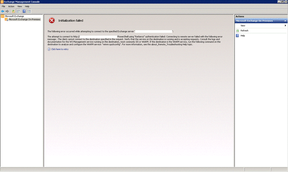

I have come in this morning to configure a mailbox only to find out that I have this error:
I have ran the 'winrm quickconfig' with no luck and I have also rebooted.
Anyone any ideas ?

Silly as it sounds, our Exchange server managed to brick itself because we had time drift between our DCs. Fixed the time, and all was well. Check all of your clocks are at the same time, on DCs and the Exchange box.

It's been a while since I've had to touch this server to be honest, I have checked IIS and I have a '?' on my Default Web Site...... NO idea why and Restart of IIS seems to do nothing.
Wish I could remember how to query in PowerShell.... Google is my friend :)
If you login with another Account does the same happen? I've seen a corrupt profile cause this error.
Are all the services with automatic start running?
I have just logged on with the Administrator account (bad I know) and same error applies. Have checked services and everything is on Automatic - except for Exchange RPC which is on Auto but delayed start.

Under System, Application eventlogs I have the following error:
WebHost failed to process a request.
Sender Information: System.ServiceModel.ServiceHostingEnvironment+HostingManager/43667493
Exception: System.ServiceModel.ServiceActivationException: The service '/Autodiscover/Autodiscover.xml' cannot be activated due to an exception during compilation. The exception message is: Could not find a base address that matches scheme http for the endpoint with binding CustomBinding. Registered base address schemes are [https].. ---> System.InvalidOperationException: Could not find a base address that matches scheme http for the endpoint with binding CustomBinding. Registered base address schemes are [https].

Check the basics first. Look at NIC settings and make sure that the DNS addresses are valid.
Make sure that the servers on the end of those addresses are healthy and in sync.
Check that your GC server(s) are all functioning too. If you've recently removed any GC's this may well be related.
Just a stab in the dark, is https enabled on the site in IIS and the correct ports binded for https?
Certificates OK?
Anything else in event logs from kerberos or domain authentication messages? DNS ok? Any clues on the DC?

Same thinking, certificate or some other SSL mechanism borked..
Everything on the DC is fine, the only thing users are experiencing is Outlook going on and off because im trying to fix Exchange. Have checked all the basics, Exchange did do an update last night and the update was a .NET update so I'm guessing that could of borked it. I've just ran A Repair on .NET and nothing has changed. Nothing has changed on any of the other servers either regarding GC or DNS, everything except Exchange Management Console and IIS is healthy.
This is a bit of a problem :( - Users cant access OWA from outside either! - this is because IIS seems to be broken - ? on Default Web Site. All bindings are correct. Nothing has changed there, it's the same as it's always been.
**Starting to pull Hair out**
Does OWA work internally? What are you getting when you try to hit OWA from externally?
Sounds like something is screwed with SSL somewhere along the line, Exchange can be a PITA if SSL configuration gets borken.

Based on that error - is ipv6 fully disbaled for the server (and not just unticked in the network card)?
