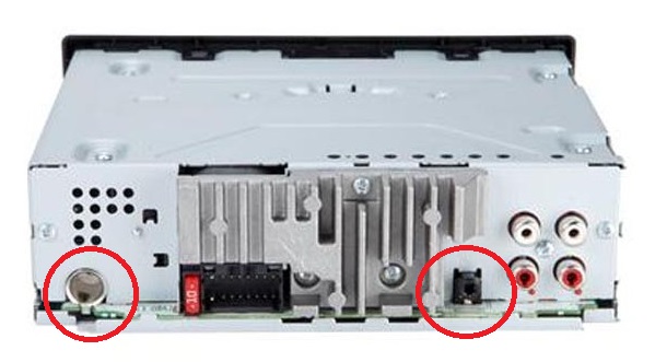

It seems the picture of what they're advertising in the first - CONNECTS2 CTSPG006, is the cable set that ensures the steering wheel control, but then in the other - DYNAMIC SOUNDS DS-PG006 (and from what I've seen from the back of the unit), it's the little 3.5mm cable that does that. That isn't shown in the first picture, I presume due to the fact you can add 'any' free patch lead to the order. So it looks like the main picture in the first one is the wiring for the steering wheel control but it isn't, that's just the power/speaker wires (?) and it's the little 'patch' lead that you add to the order that actually does the control and that isn't shown. Looks like in the second one they've labelled it as DS-PG006 as they've bundled the power/speaker wires and the correct Panasonic steering wheel control together. So confusing, I hate being a n00b :(
Anyway, looks like the aerial lead is standard and the 3.5mm jack goes in the little black hole for the steering wheel control...
Edit: The little 3.5mm hole says W/R so I hope that's something along the lines of Wired Remote, glad it doesn't say AUX IN/LINE IN or anything lol ...

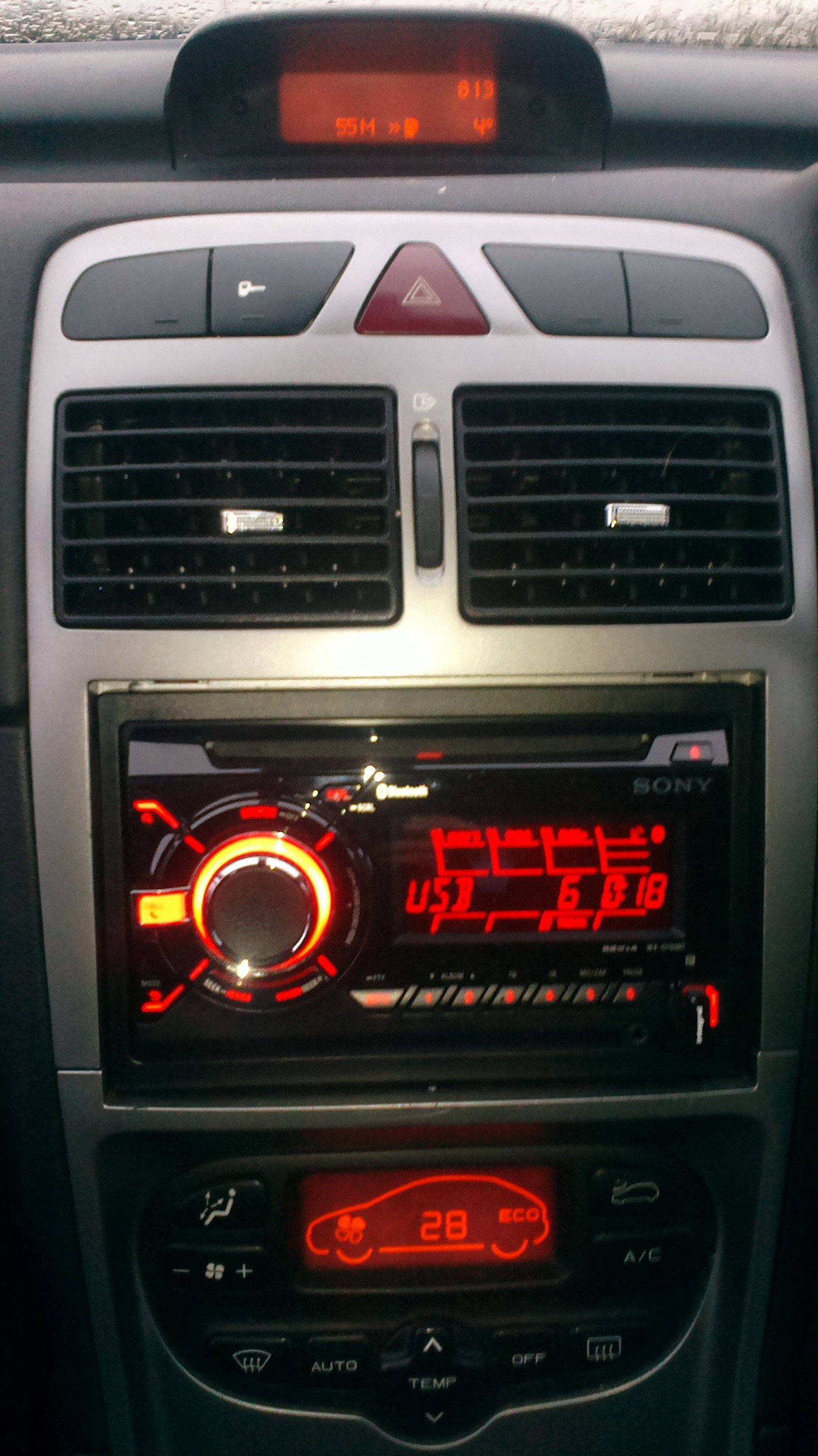

Finally got around to updating this post!
As you can see, the stereo is a different model from the ones I was looking at, due to the fact that I took the GF to choose for herself.
Halfords | Sony WX-GT90BT 2 Din Bluetooth CD/MP3 Player
The fitting was as straightforward as suggested, however I did find a huge amount of space at the back and the fact that the stereo is only really 1 1/2 din helped. I think I would have struggled otherwise as the connecting cables were quite bulky. I also did need an aerial adaptor, but I went back to Halfords to chat with the guy about fitting and dropped a hint about 'how I wasn't told it might be required', anyway he chucked it in free...
Oh yeah, the important bit... Sounds great! Thanks for everyones help in this thread! :)
