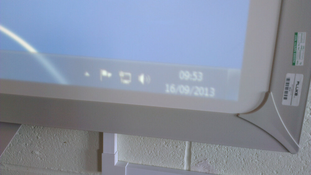

AngryTechnician Posted September 16, 2013 Report Posted September 16, 2013 I have an InFocus IN104 that is, quite ironically, not in focus. It's running at the native resolution but everything, including the on-screen menu, is significantly blurry. The focussing rings are working and I can move beyond the 'best' focus point in either direction, but the best is pretty bad. It was perfectly crisp up until a few months ago - not sure when exactly it went wrong as its in a room where staff rarely report problems, and even when I mentioned it the teacher in the room at the time said they hadn't noticed(!) Have given it a blast through with an air compressor, which made no difference. Here's what is looks like at its 'best' focus point (cameraphone unfortunately which isn't helping, but you get the idea). It's 3 years old (so inside warranty), but does anyone have any suggestions before I attempt to deal with the ever-helpful InFocus support line?

3s-gtech Posted September 16, 2013 Report Posted September 16, 2013 I had this on a unit recently - it wasn't clear even at its optimal focal point. I think something has gone wrong with the mirror setup inside, perhaps from a sharp knock or other abuse. Had to write it off though
sparkeh Posted September 16, 2013 Report Posted September 16, 2013 Wow, funny timing, I have just been tottering on top a very tall ladder on the hall trying to troubleshoot the very same problem. Doesn't appear to be anything we can do to sort it out though. I am thinking its internal...

AngryTechnician Posted September 16, 2013 Author Report Posted September 16, 2013 (edited) Have tried with a different input and as I said before, even the on-screen menu is blurred, as is the boot-up image. Lamp has 766 hours on it which doesn't seem that high to me, but I'll swap the lamp with one from a working projector and see what happens. Edited September 16, 2013 by AngryTechnician
plexer Posted September 16, 2013 Report Posted September 16, 2013 If the focus is out I doubt a new bulb will have any effect tbh it sounds like it's had a whack and the internals are out of alignment. Warranty call time. Ben
AngryTechnician Posted September 16, 2013 Author Report Posted September 16, 2013 I suspect you will all be unsurprised to hear it was not the lamp.

sted Posted November 10, 2014 Report Posted November 10, 2014 they seem to damage the internal mirrors iirc and all you can do is either put up wih it or replace it 1
Chickenman Posted August 13, 2015 Report Posted August 13, 2015 This is a very common problem with this projector, and the Mitsubishi EX200 and 240. Same lens and projector manufacturer, I believe Coretronics. The problem is the lens itself. Why they fail over time, I don't know, but I have replaced several of them. You can try DEX, who supposedly sells Infocus parts, but everytime I try to get them from DEX, they either don't respond to my emails or phone messages, or don't have the lens. Right now the only place I can get them is from Mitsubishi, and I don't know if they will sell to you if you are not an authorized service center. By the way, if you get a new lens and it is still out of focus, don't assume that the new lens must be good. I once had a shipment of three new lenses from Mitsubishi, and they were all bad.
