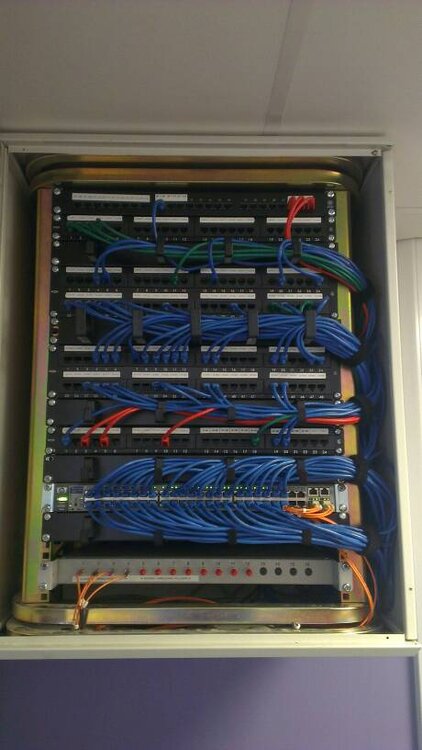

I am going to try and organise our patch cabinets over the next 6 months so that the cables refer to a colour which refers to the type of device, im sick of seeing all grey or all blue and trying to guess what is what.
I have seen CAT6 0.5m cables for £0.62 each in Yellow, Red, Black, Blue, Grey and Green. I prefer Cat6 over Cat5e but the colour selection for Cat5e is better with Black, Blue, Green, Grey, Orange, Pink, Purple, Red, White and Yellow.
I was wondering if anyone knows any suppliers who can give a price of £0.62 per 0.5m but offer a better range of colours of patch cables.

Only thing I would add -
0.5m for a patch cabinet is really short, you will end up crossing over the front of cabs which looks rubbish. Get longer 1 or 2m cables (unless the cab is teeny) you can always post some of the cable round the back to make it neat.
Is the rest of your cabling CAT6, if not don't bother with CAT6.
We used to do 3 patch panels and switch, 3 panels and switch and 0.5m is perfect for this and nice and tidy.
I would absolutely agree with this. I learned the hard way.
0.5M patch cables suck if you want things to be tidy and manageable. Longer cables and some cable management system is the way forward.
There are plenty of other options such as adding coloured tapes, sleeve Dymo onto fewer colours.
If you have paid good money to get your data over CAT 6 or better to your cabinet using cheapo Cat5 patch cables seems a bit lame to me.

Depends on how you arrange your patch bays and switches. We did our main patch area with 0.25m cables with a layout following
Patch
Switch
Patch
Patch
Switch
Patch
Then any odd ports are done with longs using velcro ties holding to the side of the cab.

Without cable management it just goes horribly wrong!
Patch
management
Patch
Patch
management
Switch
Management

I patch with longer cables and 1U cable-brush-entry panels. Looks neat to my eye. Every cable in the cab should have a unique label at either end anyway. Got the coloured ones from fruity cables.
...and the other thing about cable brush entry panels is that the hardened connections can go into the frame whereas the soft (or temporary) ones can be patched outside until they harden. Makes the changes obvious. Read the network from the paperwork plus the soft changes then once its settled update the paperwork and harden the patches tidying the whole thing up again. I'll try and post some piccies of my cabs.
