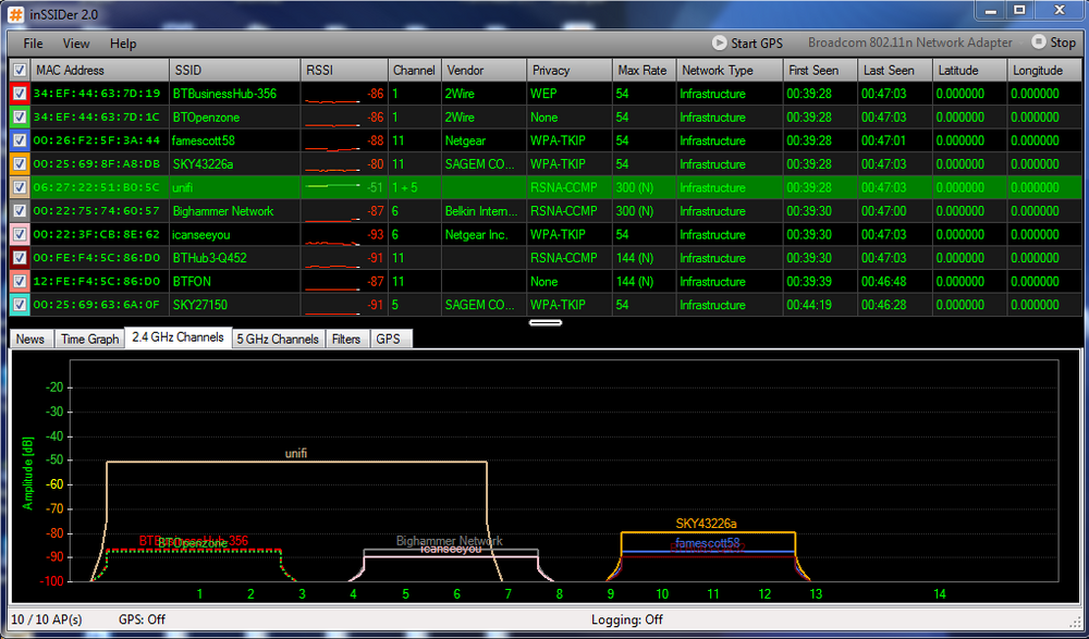

As stated 130Mbps is good going for an N radio whilst maintaining compatibility for legacy clients but if you want to play and your adapters support it try setting everything to 40Mhz and monitor the airwaves with a spectrum monitor, your neighbours will love you... mine do :evil_twisted:
