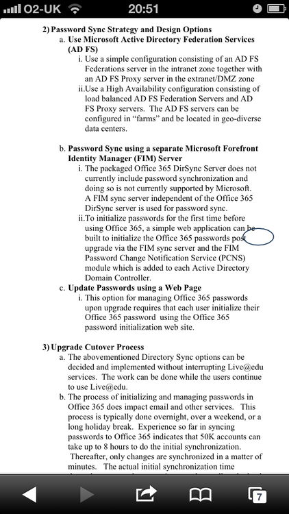

If you have setup AD synchronisation with the Azure system, does that not then have the ability to authenticate users when they try to sign on? So that, in the event of the schools AD system being down, people can still log into email?
No, because directory sync does not copy passwords to Azure.
If you set up DirSync you can still log into Office 365 even if your AD is unavailable because Office 365 holds a separate set of credentials for your users; it is only if you deploy AD FS that you become that single point of failure that requires your AD to always be available.

Yeah that's what I figured out, althoguh I think I went arround 20 different sites until I found out that it was just what underpinned it, not holding the password.
It's such a shame that it doesn't though........ ;)
Directory sync does not copy passwords to Azure.
Yet ;)
:eek:
It's not nice to tease!
Seriously though, I realise you may not be authorised to talk about it, but I'm going to ask anyway: any estimate on when that might happen? Even a hint?
:eek:
I don't believe any date has been officially published yet, but watch this space i can't see it being long now... :-)
I believe it was also spoken about at one of the recent Office 365 Conferences... so it's been put out there but with no dedicated information at present but this will be coming soon enough!
.. :p
James.
Are you kidding? It's not often I get to tease, so I take the opportunity when I can! :D
We've been working with some customers on testing PCNS-style functionality with Office 365 but at the moment we have no more information to share publicly. As soon as, and if, I can, I will.
