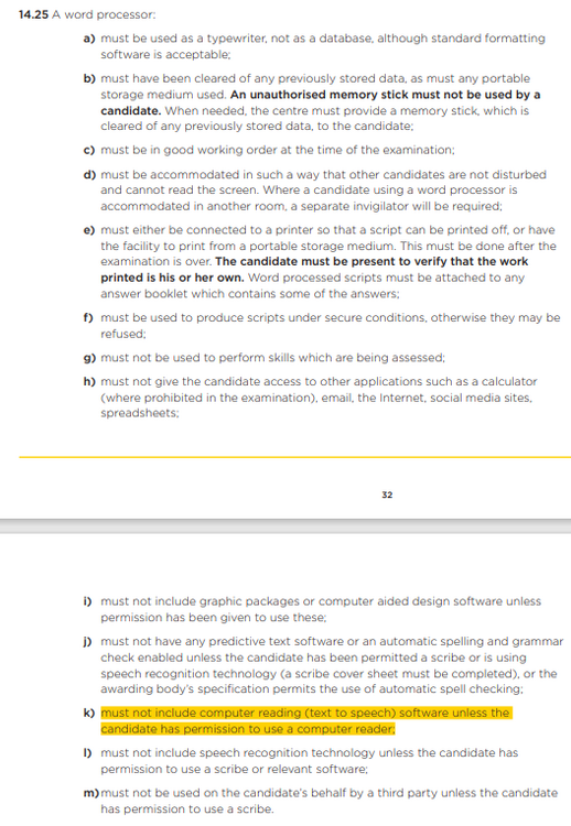

Hi Steve, We use Mosyle just recently had to do this for a similar student specifically using a scientific calculator here is a list of apps approved Exam approved Apps VI (3).docx Here's the exam guidelines as well around the IPAD Thanks Jake
