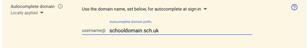

  16. Yes - There is three ways that I can think of off the top of my head. 1. You can use the Google Cloud Directory Sync with the Google Password Sync to sync over the users from your existing Active Directory. This will automatically create accounts, disable accounts, groups, password sync (only when the user changes the password on a AD computer - Its a one way sync (AD -> Google)) etc. You can then set the policies for the Chromebooks to auto complete the domain for the students (see the below screenshot). 2. If users already have an Office 365 account and your school has Azure AD sync (not required by makes the whole SSO idea better and seamless), then you can do is single sign in into Google from Office 365. For example, if a user was to sign into Google Drive, they would be redirected to a Microsoft login page to login, then once logged in, they will be redirected back to the application.This also works for logging into Chromebooks. The only downside to this is that the user needs to type their username in twice, once for Google (to check if they need to be redirected to Microsoft to sign in) and once again for Microsoft. In theory, when students are logging into Chromebooks they will be authenticated with both Microsoft and Google so if the users was to browse to Outlook on a Chromebook, they will not be prompted to sign in again. Google has a great guide on how to set this up - https://cloud.google.com/architecture/identity/federating-gcp-with-azure-ad-configuring-provisioning-and-single-sign-on 3. You could opt for the Wonde to handle the sign in, students are issued with Emoji passwords and magic badges (QR codes) where they can scan their magic badge with the webcam on the Chromebook. More info here: https://www.wonde.com/single-sign-on We have implemented the Azure to Google (option 2) in a few schools and it works quite well, it has no reliance on local infrastructure (local syncs from on-prem AD) and it is cloud native. Given the way that technology is moving (Microsoft moving towards Intune), I would opt for this way of doing it. However, the Google Cloud Directory Sync with the Google Password Sync also works well and something that we have implemented in a few schools. The Wonde solution is okay (something that I have never used) but this is something that comes at a yearly cost and isn't free like the aforementioned. Hope this helps in some way
