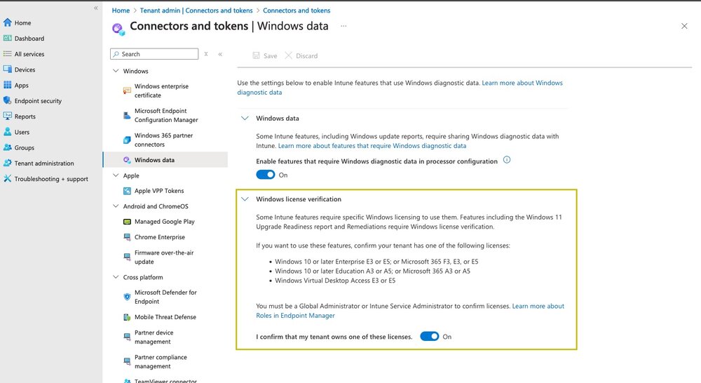

Give this box a tick within Intune and it should enable the Proactive Remediation (if I remember correctly).
