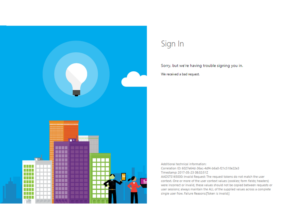

  7. Any help on this would be very much appreciated because I seem to be bashing my head against a wall over this I have test stations that currently have UE-V enabled and certain windows settings seem to be syncing but none of the custom templates do. It is writing files back to the settings share but doesn't seem to be applying any of the changes made for custom templates. I have tried generating my own templates and I have also tried using one from a blog I have seen recommended but nothing has worked so far. I am hoping to get UE-V working for Google Chrome, Mozilla Firefox, Adobe Reader 11 and VLC. We are using Mandatory Profiles that are specified within the users AD account and have UE-V set by GPO for computer configuration only - I have also tested using roaming profiles and on separate machines with no results. We have a task that applies the ApplySettingsTemplateCatalog.exe upon log on/off. The default Microsoft templates are copied to the template catalogue. Current GPO's: Enable UEV - Enabled First use notification - disabled Settings storage path - enabled - \\fileshare\uevsettings$ Settings template catalogue path - enabled with replace default microsoft templates - \\fileshare\uevcatalogue$ UE-V Blog http://djerfhowididit.blogspot.co.uk/2017/02/start-using-user-experience.htmlhttp://djerfhowididit.blogspot.co.uk/2017/02/ue-v-template-google-chrome.html

  11. I have been experiencing an error that is really annoying myself and members of staff for the last 6 weeks. Upon logging in to Office 365 using Google Chrome the user will receive the following message for the first sign-in attempt. I've exhaustively narrowed down the possibilities and I seem to have found a link but I can't quite put my finger on the specific problem. If moved from one OU structure to another one that has the exact same GPO's then it works fine (and the error message returns on moving it back to the original OU). I have found this article on Google but I don't see anything of use to my situation. We use password sync which we have tried disabling and also clearing the credential manager all to no avail. https://answers.microsoft.com/en-us/msoffice/forum/msoffice_o365admin-mso_dep365/we-have-received-a-bad-request-aadsts165000/6a2f7c86-a930-4379-8043-5b284e83734d

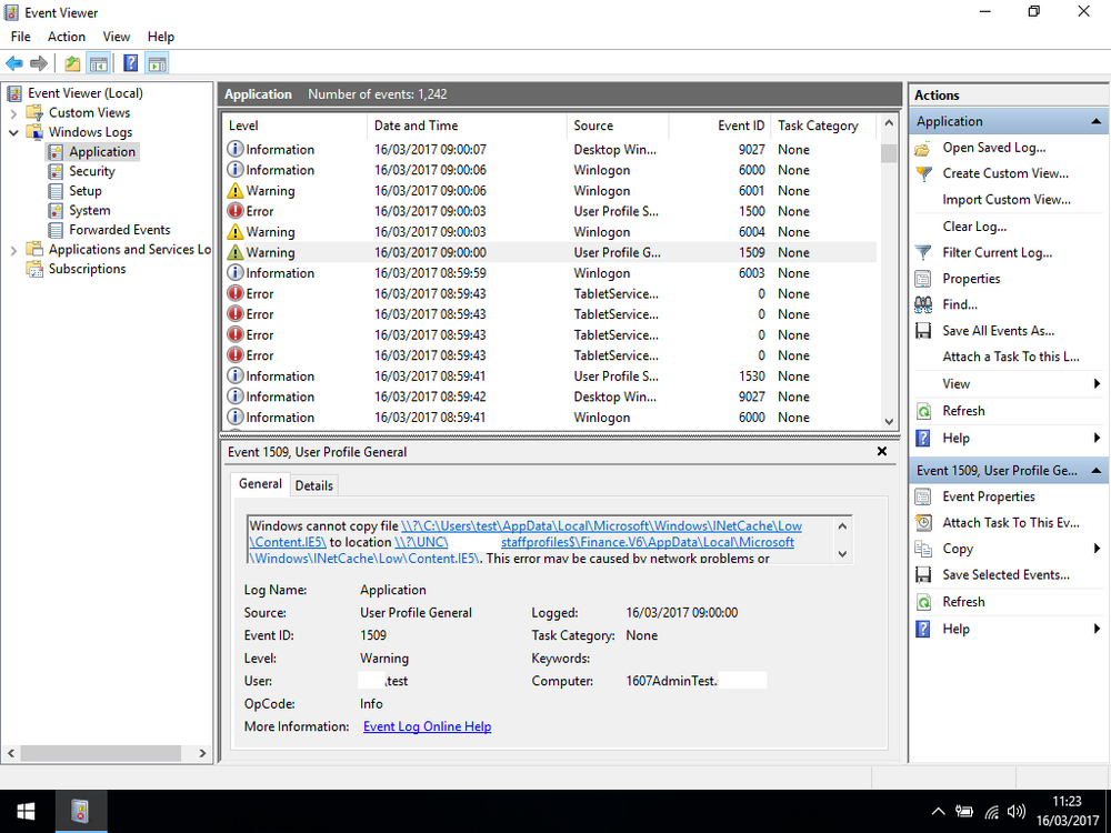

  19. I'm not sure if this is an issue anybody else is having but we have an issue with an account writing back to the "Settings Storage Path" that has been entered within Group Policy. When checking the logs within Event Viewer it shows that the user settings are trying to write back to the shared network location of our Mandatory Profiles rather than the "UEV Settings" network share that has been set within Group Policy. We use different mandatory profiles for different users (staff, students, guests) with the desktop/start menu shortcuts being placed within AppData for each profile so users only see the programs they need access to. Our problem is the Settings aren't getting saved to the UEVSettings share specified by the "Settings Storage Path" GPO under User Config and we can't rely on using the default profile as it has not been put in to our W10 build and we need a different desktop/start menu for various users. I'm a bit confused so apologies if I'm missing something obvious
