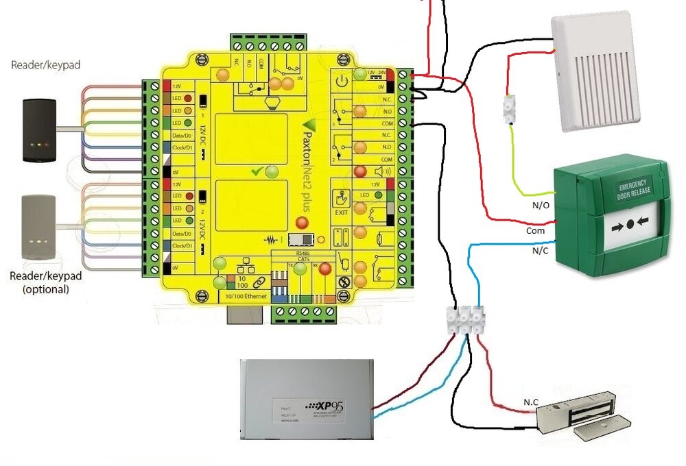

Okay, bit of an update! Got the door controller installed and working! Wiring was very straight forward; the hardest part is drilling and running cables to make it all look neat. Not much more to say really, it just works. I've put my wiring diagram below if anyone is interested, I've added a local siren connected to the NO terminal on the emergency switch so if it is pressed the alarm goes off. This is so in the case it is pressed maliciously it both to draws attention to the fact it's been pressed and hopefully gives who ever pressed it a fright so they won’t do it again. Thanks to everyone who contributed to this thread, it was a real help.

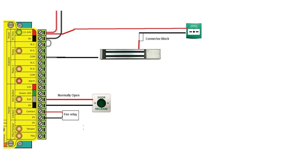

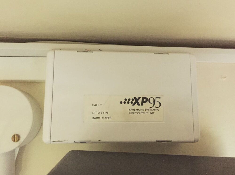

Was gonna go for the pro version anyway for timesheets so thats okay, had a look today and all our current mag lock doors have a fire relay next to each pannel, so hopefully can use them as I wouldn't want to rely on the network/software to open the doors in an emergency. They are the same relay on every door as shown below. I'll get the alarm company in to connct them up though I think. If using the contact input on the paxton would the wiring go like this? Cheers!
That's a useful diagram, thanks! I was reading you can also connect the fire relay to an input on the net2 and configure it in the software as a fire alarm trigger. Has anyone done it this way?
