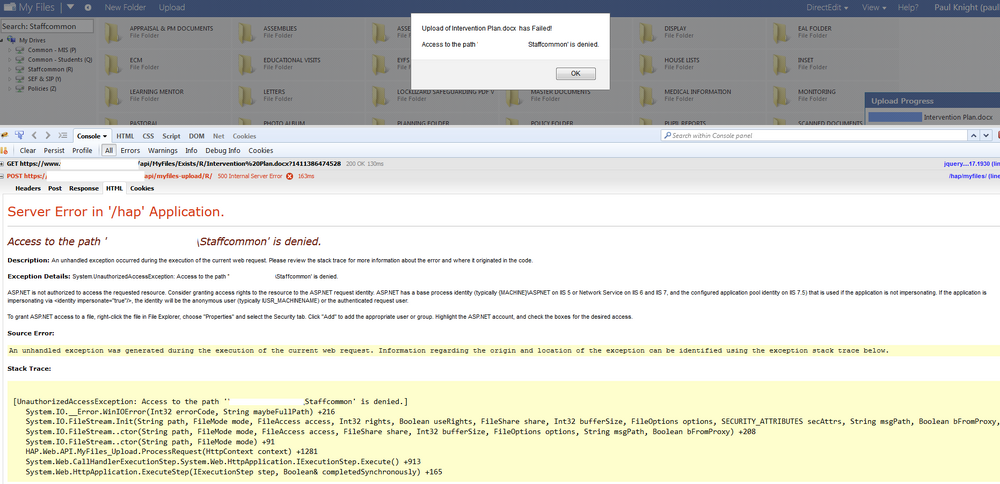

@nickbro Hi Nick, is there a quick way to disable direct edit so that I can fix it for now or am I best to revert back to my previous install? -
Update 10.3 upload error when using directedit
Paul-K replied to tj2419's topic in Home Access Plus+
I have the same issue described above after upgrading to 10.3, I also have the same error when just trying to upload a file even if I am not using the direct edit feature though. I also receive the same error in the server logs. -

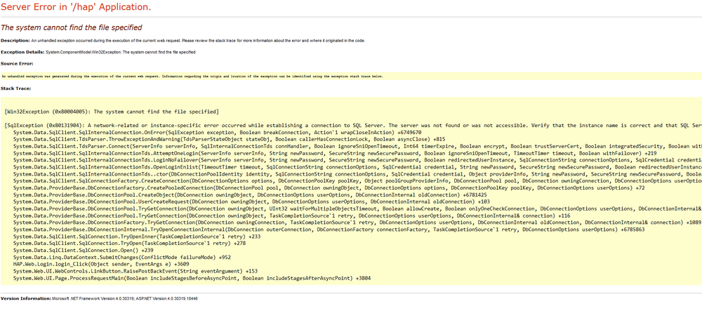

@fairm010 I didnt change that as I had it set to localhost but I've just changed it now to servername\SQL instance and that's sorted it. Don't suppose you know why I can't use localhost now thought? Does it need to have an alias set for the SQL instance to be set as localhost? -
@nickbro Hi Nick, I have installed dirsync for Office 365 today which wanted to install a fresh version of SQL so I took a backup of the HAP database and restored it once dirsync install had complete, the original SQL instance was called SQLEXPRESS, the new one was named automatically by the install as MSONLINE. The restore of the database to MSONLINE has gone fine and all the tables are there but HAP+ won't login, it's showing the below SQL connection error. I have added the IIS AppPool to SQL, I have enabled named pipes and tcp/ip for the SQL server and when I type SQLCMD - L in command prompt, the server is in the list, I have also changed the SQL connection in IIS, is there anything I need to change in the HAP files because it already registered itself to another database name or something like that? Your help is appreciated
Cheers Nick, that sorted it.

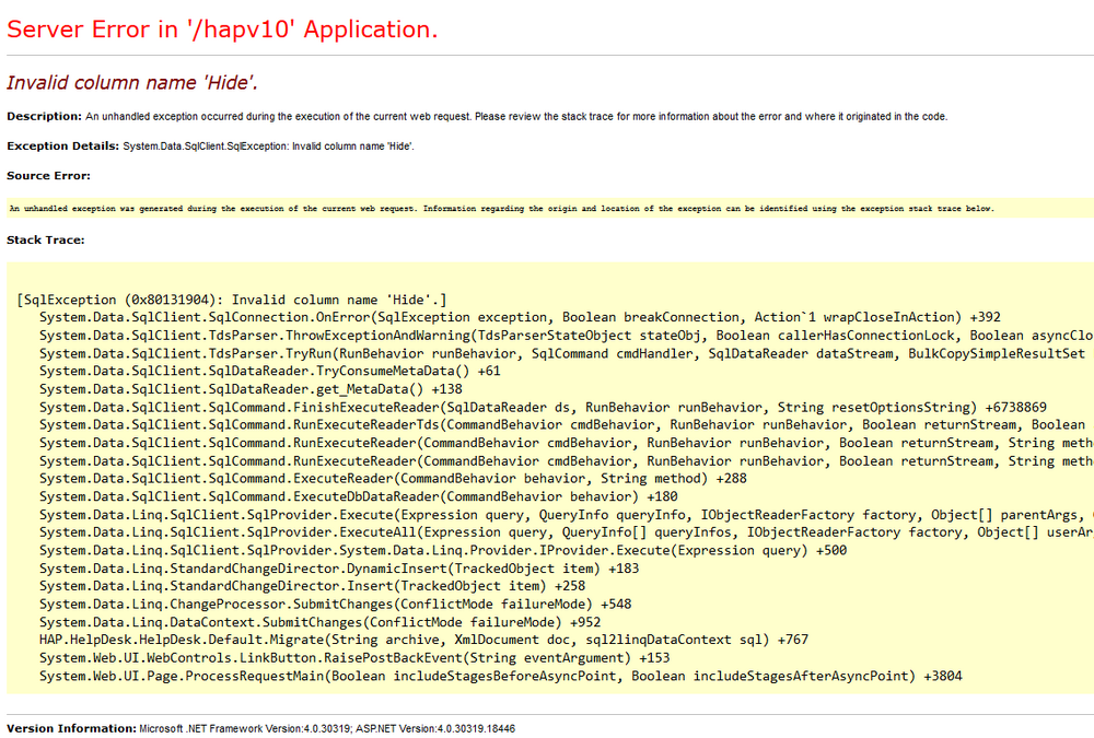

@mattgrimley Hi Matt, you will need to use the HAP.sql file from the HAP+ Web Core v10.1 Update, this is the latest one which includes the column called hide in the note table. I would recommend dropping the three tables that have been created, Note, NoteFiles and Tickets providing that they are empty and running the HAP.sql again as it will error otherwise. You will need to delete these in a specific order as they depend on each other, I believe I did NoteFiles, Note then Tickets. I also took a backup of my HAP database to be sure but didn't need it. Hope this helps -

Cheers Nick, that sorted it, all working perfectly now. -

Have replace with the latest Help Desk update and now get the below error, the help desk is also no longer showing any of my tickets but they are still in the file tickets.xml -

@nickbro Just had a quick look through the SQL and it seems to be missing the NOT before EXISTS in the below statement which is what then drops the table. /****** Object: Table [dbo].[WebTrackerEvents] Script Date: 03/12/2011 17:44:19 ******/ IF EXISTS (SELECT * FROM sys.objects WHERE object_id = OBJECT_ID(N'[dbo].[WebTrackerEvents]') AND type in (N'U')) DROP TABLE [dbo].[WebTrackerEvents] GO -
@nickbro Hi Nick, great job on HAP+ v10. Just a quick one, I have run the latest HAP.sql to add the tables for the help desk but it seems to have cleared all my tracker/web tracker events during the process. I took a backup of my database before I upgraded so can restore the data, but is the script supposed to clear all the tables?
