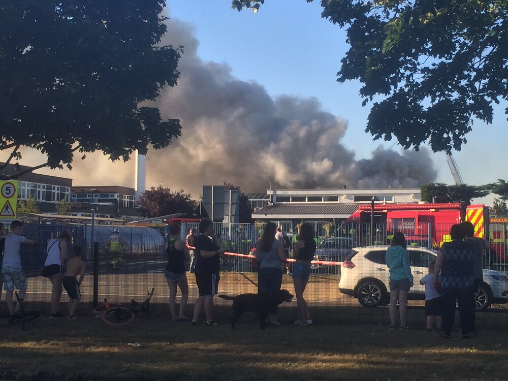

  9. I've just been standing outside Cecil Jones the fire is rumored to have started after an accident during the Re-Roofing work its spreading very quickly
