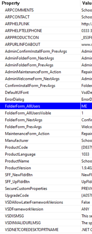

Hi I'm trying to edit an msi file so that instead of a radio button be pre selected for a 'just me' selection it will pre select the 'everyone' option. The options are selected via a radio button. In the properties table of the MSI, I have found a property named 'FolderForm_AllUsers' the value of this is 'ME'. if that value is changed then the 'just me' option is no longer pre selected but neither is the 'everyone' option. I've tried replacing the 'ME' value with the word 'EVERYONE' but it doesn't seem to make a difference. Has any one any experience with using orca that might be able to lend a hand?

sod law that after looking and looking I resolved it just after I posted the issue. I've now got to get it to select one of three buttons. 'Typical', 'Custom' or 'Complete'
