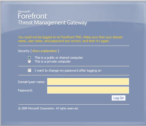

When connecting from outside we are using a HTTPS address. I'm not sure about the tunnelling or how to check? But all servers have the wildcard cert installed too since before this error started happening. The only change that's happened so far is the expiry of a local cert which I believe was issued by the DC a long time ago to all workstations and servers (its some sort of internal, non-CA certificate). After deleting this, there was already another valid local one (also already installed on all machines) which really should have taken over. But we still get the error above. In Event Viewer though, I saw this today: "schannel The following fatal alert was received: 0" Googling a bit tells me it has lost the trust relationship to the DC and needs to be reset. The last post on this page has a command to reset the trust. Think this may be relevant and safe to continue with? Event ID: 36887 Source: Schannel, Error: The following fatal alert was received: 0.
2 days ago, we noticed we couldn't login to HTTPS addresses from outside to inside such as webmail or VLE. Whenever we logged in, we got this: We noticed a certificate had expired. It is a local certificate which appears on every workstation and server. It seems to be one that is issued by the domain controller. We removed this certificate off the domain controller and the TMG server, as well as critical servers like Exchange and SharePoint (VLE). There is another certificate already on these machines with a valid expiry and intended for "All Purposes". We have performed a gpupdate on the all servers but we still get the above error when logging into anything that passes through TMG. Any ideas what else it could be? Thanks. If we go to TMG Best Practise Analyser we see:
