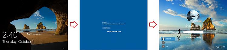

  2. We have branded our windows 10 install with our wallpaper and colours. However i'm unable to find the location in GPo editor which allows me to change the colour of the middle screen below: The blue looks totally out of place with our colours. Does anybody where i can change this? We use this screen as our AUP. Cheers

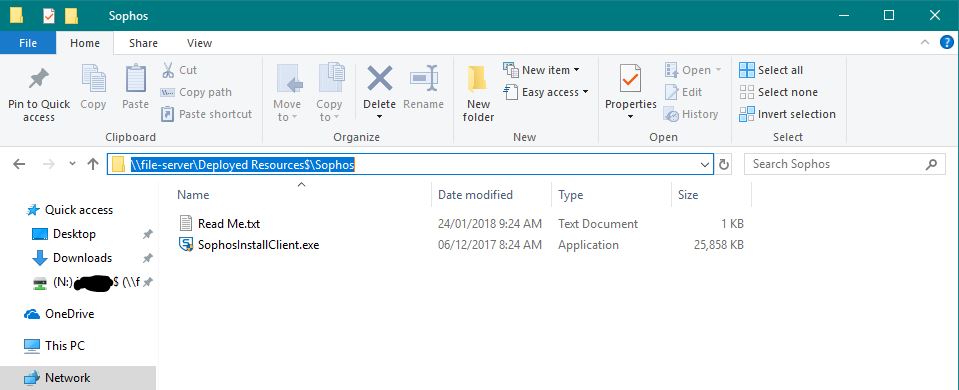

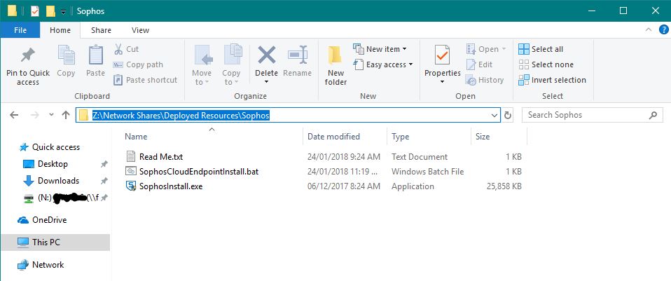

  4. Sorry guys, i think i've over complicated my description of the issue i'm having. To clarify, i have managed to get the client av software to install (typo on the .exe i was trying to launch) one of those days. What leaves me baffled is that i can't "see" bat files on a server share i access via a unc path. I can only "See" them via a mapped network drive. as per the screenshots
  5. Yeah like i say the .bat file works fine when i launch it directly from the a mapped drive location. if i \\ into the server share i can't even see the .bat file. as per the screenshots
  6. I'm really confused as i've never seen this behaviour before. I've also put in the server 2016 section as i'm able to replicate this on both windows 7 and 10 machines to my server 2016 file server share. Sorry if it's in the wrong place Ok long story short, i've been trying to deploy a av client via an ad startup script and it's been failing to install. it uses a .bat file located on a hidden unc share that all users have access to. If i launch (or try) to launch the .bat via unc path i get an this location (or rather file) doesn't exist error. If i launch the .bat file direct from a mapped network location it works fine. see the screenshots below, both locations are on the same server in the same share location. The only difference is that the one where 3 files are visible i've used a mapped drive to view the location. And the one showing 2 files is using a unc path. Any Ideas?
