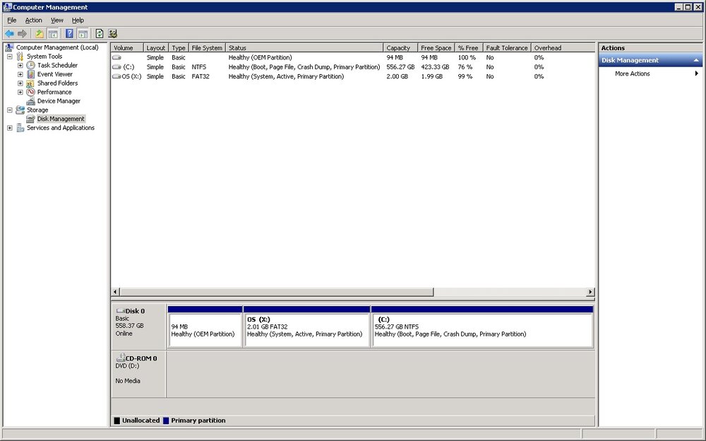

  16. What If I shrink the FAT32 (X: ) partition and make an NTFS partition in the space called (Z: ) then copy the contents of (X: ) to (Z: ) and then delete (X: ) and put the space into (Z: ) if you follow lol... I dont have the time to start again with the server even with the backups I've got. Its all the settings that I dont have backups for, hence wanting to use WSB. I have a NAS drive that I use for backups.
  17. I think I'm going to have to do some testing before I dive in. I'll setup Win2k8 on a spare desktop and see whats what. Cheers for the help! EDIT Yeah I'll try and get you a screen shot.
  18. The server is installed on NTFS. The boot partition is FAT32 at least I think its the boot partition its 2GB. A Google reveals lots of other people who have the same problem. The problem is when I installed it I installed it like any other OS I've installed a million times before so how do I know its not going to create this FAT32 partition again?
  19. Its odd. The actual OS I think is NTFS (C:) but this is a hidden partition that says (OS) and I think it contains the startup files To think about formatting it I had to assign it a drive letter. The server is a Dell T410 and the OS was downloaded from Microsofts website via my IT supplier. I only found out about the partition when I came to use Windows Server Backup and it listed the partition. It won't let me do a bare metal recovery as it doesnt support FAT32. If the partition does only include startup files, does the cluster size matter? The (OS) parition contains the following files. Boot (Folder with language folders and the file bootmgr.exe.mui in each folder) Recycle Bin Bootmgr - system file BOOTSECT.BAK I'm actually not sure, I think its software (onboard controller) Device manager says: Dell VIRTUAL DISK SCSI Disk Device
  20. I think we are talking about the same tool from cmd prompt... "CONVERT X: /FS:NTFS" The server is in RAID1, how would it affect the raid?
  21. Has anyone used Convert.exe to convert a FAT32 parition to NTFS? I will be doing so next Monday and I just want to know if anyone has had any problems using it. I need to format the OS partition on my Windows Server 2008 R2 to NTFS in order to use Windows Server Backup. I've made a backup of the partition but just I was wondering if there was anything else to expect. The server is in production but we'll have some downtime during the day so I need to sieze the moment. Cheers.

  24. I'm trying to use WSB for the first time and when I try to do a full backup (server data, applications, system state) it says "One of the specified source volumes has an invalid format and cannot be protected using Windows Server Backup. Only volumes formatted with NTFS can be protected" There are 2 volumes in storage manager. (OS) (fat32) (C:\) NTFS I get the same error even if I don't select the OS
