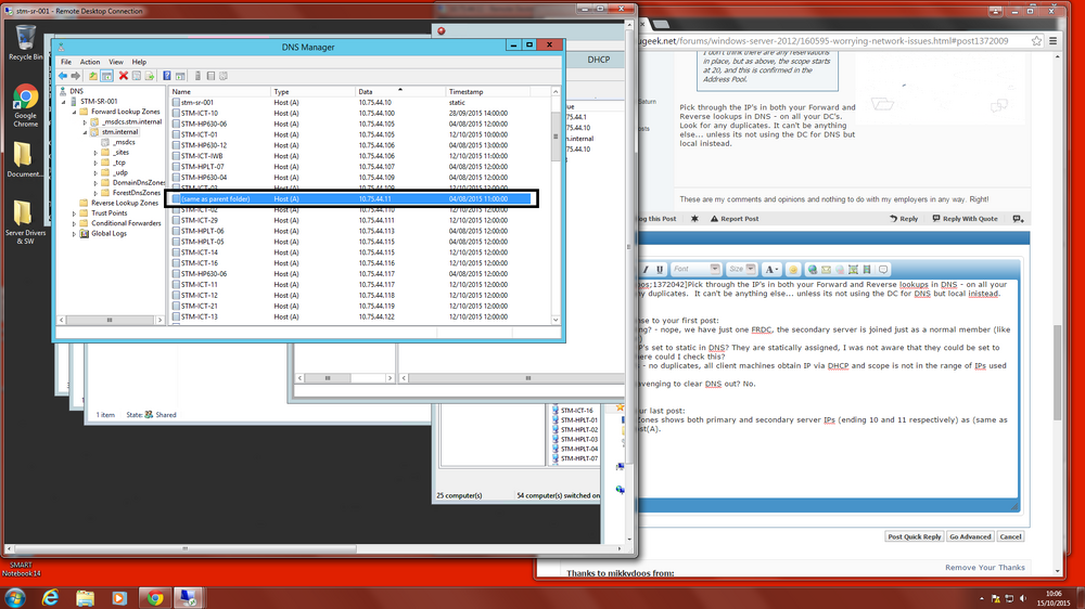

  9. Thanks for your helpful posts. In response to your first post: Are they replicating? - nope, we have just one FRDC, the secondary server is joined just as a normal member (like a client computer) Are your server IP's set to static in DNS? They are statically assigned, I was not aware that they could be set to static in DNS. Where could I check this? Any duplicate IP's - no duplicates, all client machines obtain IP via DHCP and scope is not in the range of IPs used by the servers. Are you using Scavenging to clear DNS out? No. In response to your last post: Forward Lookup Zones shows both primary and secondary server IPs (ending 10 and 11 respectively) as (same as Parent Folder) Host(A). Reverse Lookup Zones is empty and has Add a New Zone as title. "The Domain Name System (DNS) allows a DNS namespace to be divided into zones. Each Zone stores information about one or more contiguous DNS domains. To add a new zone, on the Action Menu, click New Zone."

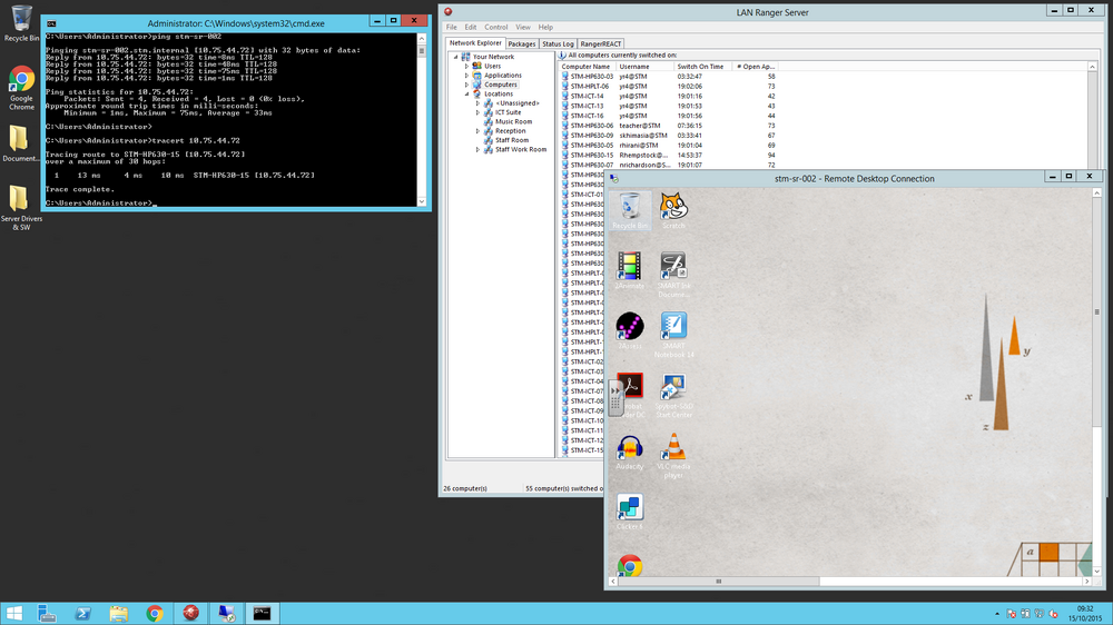

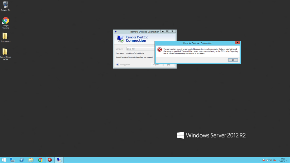

  11. Good morning, I am not quite sure what on earth has gone wrong here. We have two servers running on our domain. An FRDC running Ranger 8.0 on Windows 7 client computers. We then have a second server which is joined to the domain just as a member and serves as our antivirus and backup server. Both run server 2012. The FRDC has DHCP, DNS and Active Directory with a statically assigned IP of: 10.75.44.10. Its host name is stm-sr-001 The second server has a statically assigned IP of: 10.75.44.11, its host name is stm-sr-002. I am finding it impossible to rdc to the second server using it's hostname. If I try even from the FRDC, It connects me to a class room computer. It first says that the connection cannot be completed (when authenticating with the domain administrator account): If I use another domain account, it authenticates, and works, but loads up an RDC session for a class room computer: You will notice in the above screenshot, I have also pinged the hostname of the second server (from the first) and then tracerted it and found that the hostname is indeed a classroom computer. If I rcd the secondary server IP address from the FRDC, it works. What could be the problem here? I have attempted a DNS restart, DNS flush and bounce of both servers, but it has not made any difference.

  14. Ok thanks. Do you know where exactly this option is? Hi, thanks, have taken a look and all I have in forward dns entries is shown in the attached screenshot. Reverse is empty.

  17. Hi, yes I meant the TCPIP settings. As far as I know, there is no entry for server two on the DNS for server one. Is there any way I can check this?
