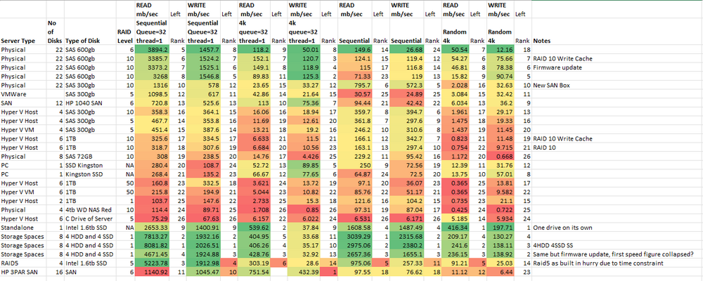

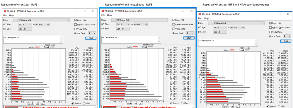

I originally wanted to go with RAID60 but did not seem to be an option. Potentially RAID5 nowadays is not enough? Also some interesting network config to look into. A ping with -l 9000 fails.. so looking at Config on Cisco side
Interesting, the major difference seems to be i get poor write speed. Which almost sounds like a setting on the SAN New results with SAN volume now reformatted to NTFS
The issue is more speed testing it is slow compared to StorageSpaces, even though SAN is All SSD Re tested using ATTO from VMs 2 * Hyper V Hosts - Dell R630 1 * RAID1 - OS 4 * Intel SSD and 4 * HDD - StorageSpaces on each Worked well however the 4k video requirement has meant space issues StorageSpaces retained but SAN for more storage requirements greater than hosts have and HDD tier is slow SAN also gives snapshots and use of cluster Setup with ReFS however seems this is incorrect so as its not live going back to NTFS https://learn.microsoft.com/en-us/windows-server/failover-clustering/failover-cluster-csvs
Using iSCSI SFP modules direct into chassis, no daughter card HyperV - - - Updated - - - Already use StorageSpaces but 4k video and alike meant capacity has become an issue. Also when it falls back to the HDD tier as it fills the speed collapses
Hi, We recently purchased a HP 3PAR 8200 SAN with 16 * K2P91A - 3.84tb drives Initially configured as RAID6 4 * 10gbps connected to Cisco 6506 2 * Hosts - Dell R630 with 2 * 10gbps connected to Cisco 6506 for SAN Jumbo frames enabled The performance is not quite what I was expecting Previously I have used Crystal Disk Mark Is Crystal a fair test of SAN? Unsure if Cisco side the links should be Aggregated via Port Channel? Raid6 is obviously more fault tolerant and slower than some other examples Thanks

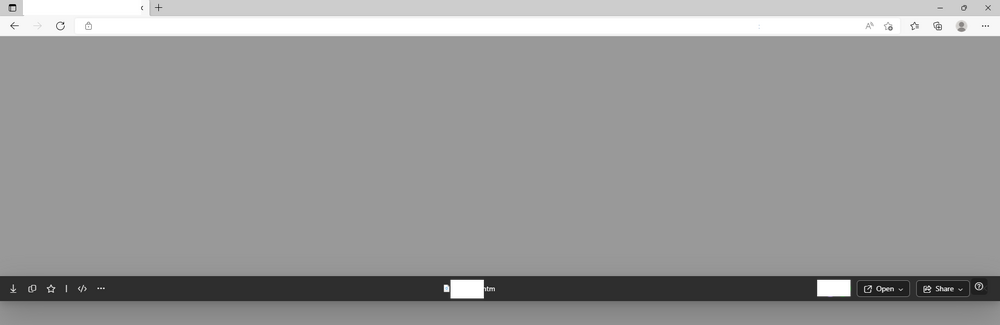

Seems to be related to URL Issue occurs on some PC's where the URL ends web=1 Changing to Web=0 works Awaiting feedback from Supplier of system we use -
Image attached. Its not all PCs Using Edge Tried different users Resetting settings etc to no avail Anyone seen this before? Thanks
