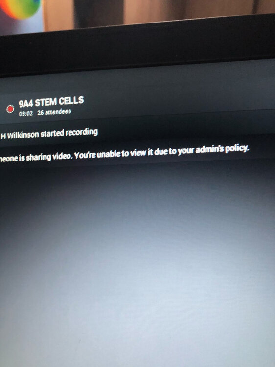

  15. Is anyone else getting reports that not all attendees to a meeting are able to see a screen share? I think this is mainly affecting sharing of the full display and not just a PowerPoint. I've been sent a screenshot by one pupil who seems to get the issue. However, their policies match all other pupils. I can't see any differences anywhere. I also get informations sometimes that sharing of PowerPoints shows on some pupils screens but not others. From what I'm hearing, this doesn't effect the same pupils all the time. Again, there's no differences anywhere. All classes synced by SDS for what it's worth. Cheers.
  16. Thanks for that. That matches what I'm thinking, although we have had some odd issues pop up over the last few days. Randomly teachers have started getting directly applied meeting policies (RestrictedAnonymousAccess) when they should come from a group membership. That's new! Plus trying to get a recording removed has proven to be impossible even though Microsoft support can confirm our settings are right. It's turning into a long week.

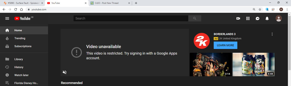

    Good morning everyone. Is there anyone on the CLEO network with NetSweeper experiencing intermittant issues with YouTube vides? We are seeing a number of videos failing to load with the "Video unavailable. This video is restricted. Try signing in with a Google Apps account". What is really odd is that I am signed in to Google with my personal account. The issue has even now shown up on the top advert on the YouTube homepage. Not all videos affected, but a number seem to be on any system around our network but not outside of school. I've looked at the NetSweeper logs and nothing stands out as blocked. Another affected video seems to be: Thanks in advance to anyone who can take a look. Cheers!
