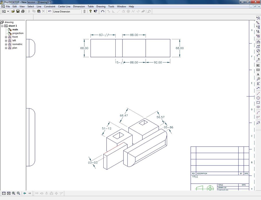

I didn't find a solution using Win7 32bit. However, we installed Windows 7 Pro 64bit on our PCs this Summer and since then, the dimensions in ProDeskop are working as they should.

Hello, I'm having some trouble when using the "Linear Dimension" tool in an Engineering Drawing with Pro Desktop 8 (build 1067 running on Windows 7 x32 bit). When I use the linear dimension tool to measure part of a drawing, I sometimes get a strange measurement that displays a value of something like 15-// or 03-03 instead of a normal measurement like 92.00 or 88.00. Does anyone know of a way to stop this happening? Or could this be something I am doing wrong? I've attached a screenshot of the problem so you can see what I mean. Any help will be appreciated. Thanks.
