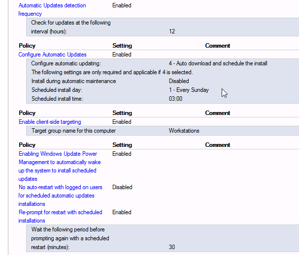

WSUS assistance - Downloading and installing only on demand
Domino replied to ITPonds's topic in Enterprise Software
It's doable with just the GPO settings. For instance the settings below will install updates at the time listed when they're released. Manually releasing updates means you can be sure the day the reboot will happen. -
