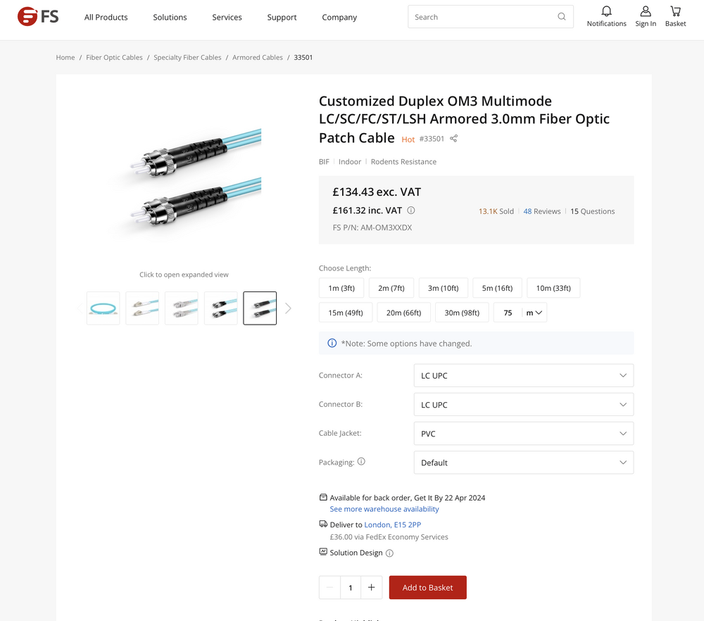

Thanks for the info! Would this be suitable? I couldn't find much that showed pre-terminated that was outside-grade. Black PVC conduit is designed to protect from UV etc I think?! 🤣 In terms of the SFP vs SFP+: Could I buy 2x SFP+ modules (inc. 1 for the non-SFP+ capable switch) then & it would auto-negotiate back to the correct speeds? The SFP Switch is Cisco so will have to look into if such switches are 'fussy' over which bits etc are used... :/ -
Hi all, I'm doing some network upgrades in my house & would like to run some Fibre-Optic cable between two switches I have in the house. Complete 'newbie' when it comes to Fibre; so I need some guidance as to what cable/bits I need to purchase. Here's my setup: Firewall is Sophos XG w/ the 10-Gigabit SFP+ Module(s) installed, I'd then need a cable to go between this & my Ubiquiti 48-Port PoE Switch (that also has SFP+) ports - THEN, I'd be going from this switch, through the floors (under floor-boards) and out the exterior of the house for approximately 5m (likely in conduit?) before going into the annexe where it'll connect to the next switch. Everything is 10-Gig capable apart from the last switch. Does it matter if I just use an SFP+ and then a SFP module to connect the switches? Any cable that's recommended? Aware there's loads of different types. Aim is to upgrade the last switch to 10-Gig capable when finances permit...! Thanks.
