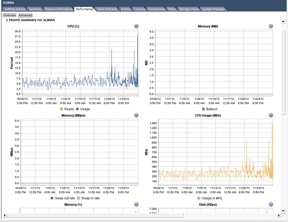

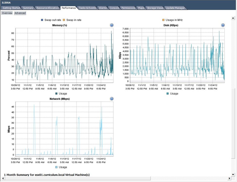

It's our mail server and users have been reporting mail being slow...
I've run a few disk defrags which seems to have helped slightly...
The attached graphs and settings should hopefully allow someone more knowledgeable than me to advise if I can up the resources for this server?

Memory is expected to be that high, disk usage seems to be rather alot.

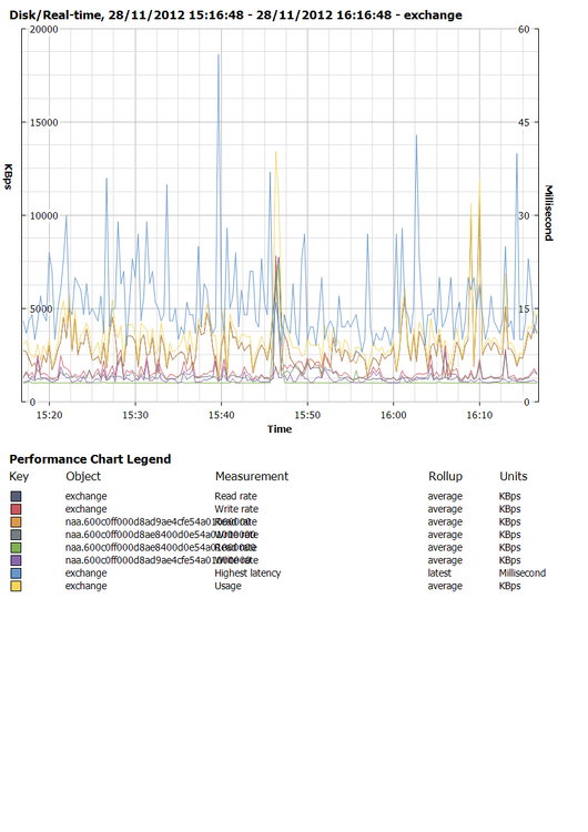

my exchange: exchange.png

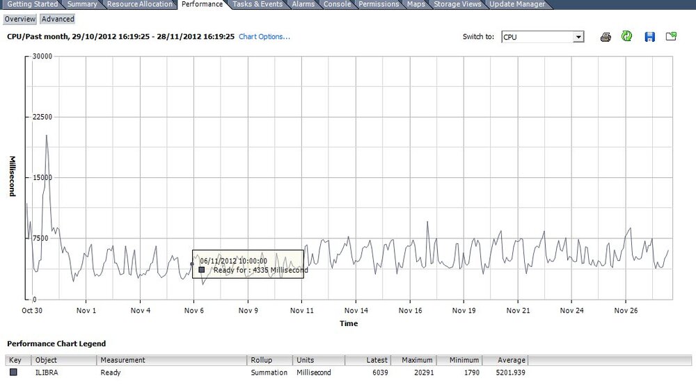

You should be able to change it in chart options in the advanced tab.
I would also check the latency in Datastore view.
