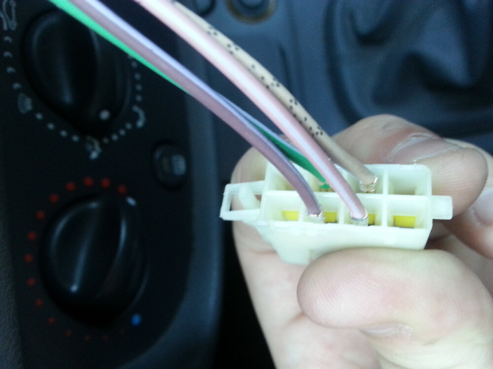

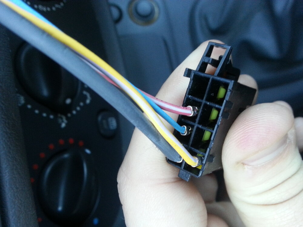

glennda Posted November 11, 2012 Posted November 11, 2012 I'm looking to put some speakers in a car for my little brother along with a new Head unit. This car doesn't have any rear speakers I can splice the audio connection from which is what i did on my previous car (disconnecting the old speakers). What i am proposing to do is detach the speaker connection from the back on the head unit and then run new cabling through the car to the back. My stumbling block is i don't know which cables are the speakers. Is anybody able to shed light on it? The attached are the pictures of the connections in the car. Its an S reg Renault Clio if thats any use to people!
3s-gtech Posted November 11, 2012 Posted November 11, 2012 Top connector is for speakers. For sound quality, it's always best to keep the front speakers connected - rears are far less necessary. If you're looking at 6x9s on the rear shelf, also bear in mind that fitting them often causes the structure of the shelf to fail with the weight, and they are a very obvious theft magnet. Can you upgrade the fronts instead? Or even better, utilise the rear outputs from the headunit by swapping out the car's white ISO connector for one with four channel output (just a case of cutting it off and joing a new one in). That way you can keep the fronts, and run speaker wire to the rear from the other channels). 1

crc-ict Posted November 12, 2012 Posted November 12, 2012 What I would do is get hold of the cheapest wiring adaptor I could find that had ISO connectors (the black and white plugs in your pics are ISO connectors), then remove the two outer pairs of connections from the white connector, splice them to new speaker cables and then insert these connections into the car's white ISO connector. Voila, you then have wiring for rear speakers and the car's original wiring is intact. Older Renault's can have debatable wiring so it's best to avoid messing with the car's wiring loom if you can help it.
3s-gtech Posted November 12, 2012 Posted November 12, 2012 ^^Basically what I would suggest - but I always found it tricky to get a good connection using a two channel speaker connector for the car, which is why I suggest putting in one from a four channel setup. You won't affect the general condition of the electrics by doing this! You cannot run both front and rear speakers from the same two channels from the headunit though as I think you've suggested - you end up running two 4ohm loads in parallel per channel which = 2ohm. Most headunits get very hot and may be destoyed with such a low impedance on the amp.
crc-ict Posted November 12, 2012 Posted November 12, 2012 Sorry, yes bit of confusion, I was suggesting adding terminals to the four vacant outer positions on the original car connector to provide the rear speaker feed. The connector allows for front and rear L & R outputs, just the current connector doesn't have the terminal pins fitted. Certainly, don't wire extra speakers to 'piggyback' the front connectors!
