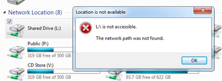

Screenshot of the error below:
It will be connected and then suddenly next time you go to use it you will see the error above. Nothing bar restarting will reconnect the drive. Weirdly the O drive which is on the same server is connected and working fine!!!!

Caching was enabled on the share, the reason we turned it off was that we didn't want the ability for staff to use the massively shared drive at home and cause conflicts as it would be likely that they would never be resolved. Weirdly we noticed that Windows had decided to sync random files DESPITE setting the options to stop other shares being synced... we only noticed this when a staff member came to us with a drive which only showed the files which were syncing!!! So the drive had disconnected and was 'offline' but the computer was 'online' as such, able to get other shares from the same server and access the internet.
What isn't clear so far is if other drives are disconnecting and going into Offline mode without anyone noticing, the shared drive (L:) is obviously quite heavily used so it will be the one people notice.

By 'caching was enabled' I mean it was set to 'Only the files and folders users specify will be available offline'. As we have the Make Available Offline bits disabled you would think that Windows wouldn't cache these drives and make them available offline. However Windows 7 is much more intelligent than us and makes the decision for us..............................
