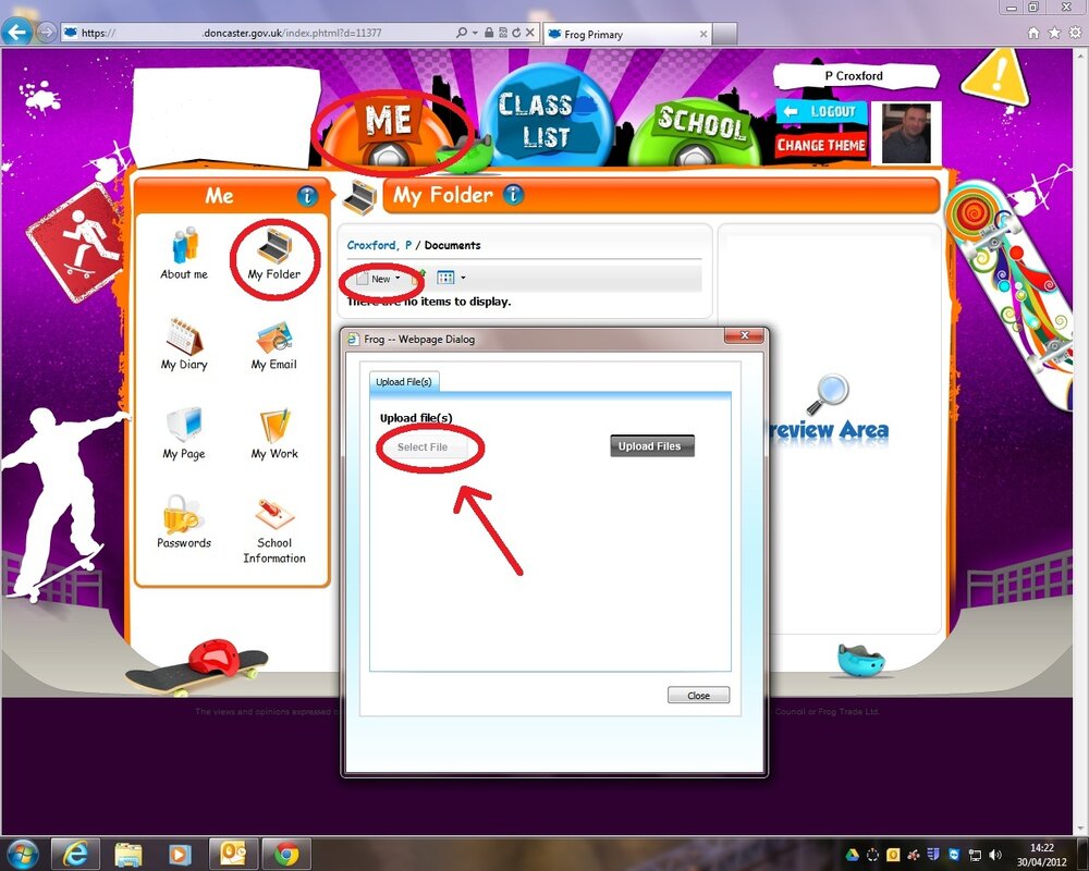

Hi
I'm a IT Technician in a school in Doncaster. we have had the Frog learning platform for the past year
I'm having a few issues with uploading a file within my files area.
I'm using windows 7 Professional SP1 64bit and have the latest adobe flash, but i believe the problem stems from using Internet Explorer 9
the problem I'm having is, when i go to "ME" area, then go to "My Folder" then click on "New then "Files" the window popup comes up, but when i click "Select File" the whole window locks up, including the one behind it
now I've gone over a few things, GPO's, obtaining the latest version of Flash player (both 32bit and 64bit!), and still no joy, I've even reformatted and not joined to the domain and tried then but no luck, I've tried Firefox and chrome and these work perfectly fine, but i don't want to have to use them
i did disable flash player in IE9 and it works fine which is wierd!!??
I've been in touch with my local LEA at the council about my problem and they are even scratching their heads at this one.
I have attached a picture of my problem
have any of you had this problem and how did you solve it!
please help me before i go mad lol :-)
Hope you can help
Regards
Phil Croxford
Edited by phillip_croxford
tried that as well lol doesn't want to know. I'm very sure its a IE9 issue!! its a bag of pants really. it would be better if software developers started to introduce HTML5 coding, as i hate adobe flash player. so much can go wrong with it
Have you tried the simple uploader? There should be a link somewhere on the upload screen - this usually works for us. This is a problem we have had recently and one I think Frog need to fix rather than providing workarounds.

Thanks chazzy2501 but i don't even have that option! so the answer to your question is no. i don't think they have updated us

Mitchell1981 thanks for your reply but doesnt work. ive tried it! and no luck :(

it seems if i disable Adobe Shockwave Version 11.1.102.62 from the "Manage Add-ons" screen it brings up the Simple uploader. and works!!! finally im getting somewhere :-)
i deployed this through GPO last year. and seems to be the culpret???? not sure what do you guys think.
do i need to down grade me shockwave to get it working properly?
Got 11.1.102.63 here, Shockwave we install on every machine but we never used GPO to deploy this one. We just install exe or use site for images.
Perhaps try a manual update from website instead of using GPO see if that helps?
Update 2!
i can now confirm it is my Adobe Shockwave msi installation i downloaded from the adobe site, i did deploy this file through out the school. it has corrupted all my pcs in school and will have to rebuild a new school image!
