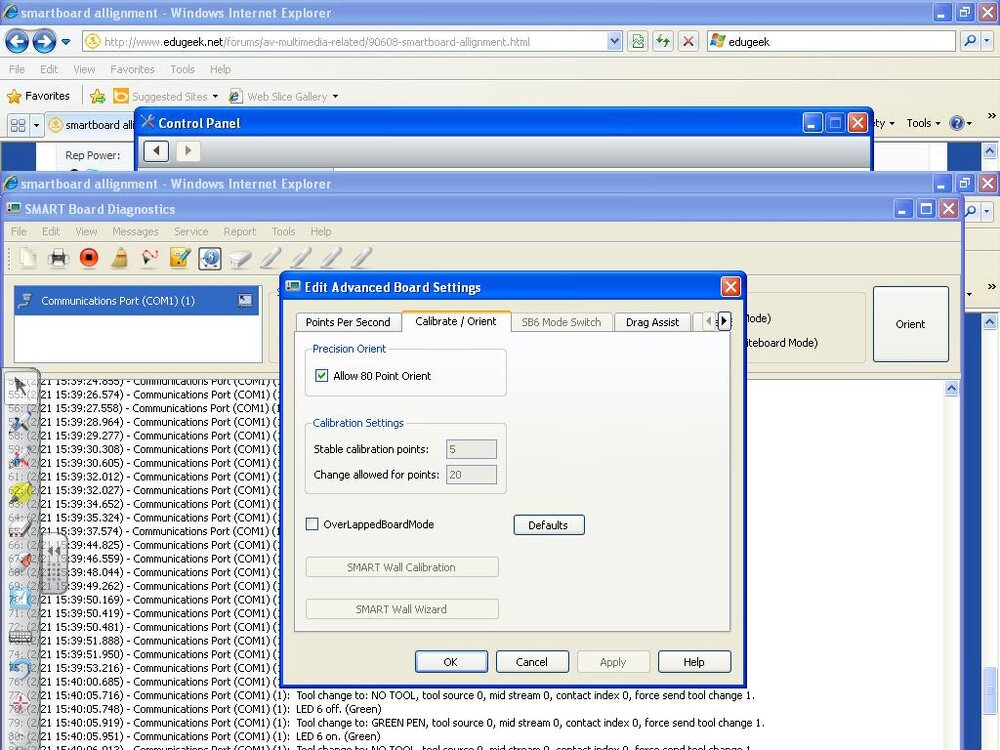

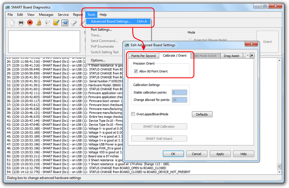

cheers fokes done as angry said put the tick in the box but cant find
You should then be able to select 80-point alignment in the normal options.
when i click orientate its still 9 point

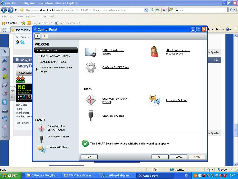

cheers fokes done as angry said put the tick in the box but cant find when i click orientate its still 9 point
You still need to set the option for it, this tickbox just enables the 80 Point option that is usually hidden. The option is in the normal Control Panel settings under Orientation/Alignment settings. Should be right underneath the 20 point option.
