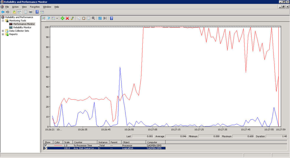

Average disk queue length (ADQL) is all over the place. Having monitored it for a couple of minutes I saw values of 30, all the way down to fractional figures.
I ran a whole school query, which again maxed out the processor (mostly) and then I saw peak ADQL values of around 70, but with average values around 1-2.

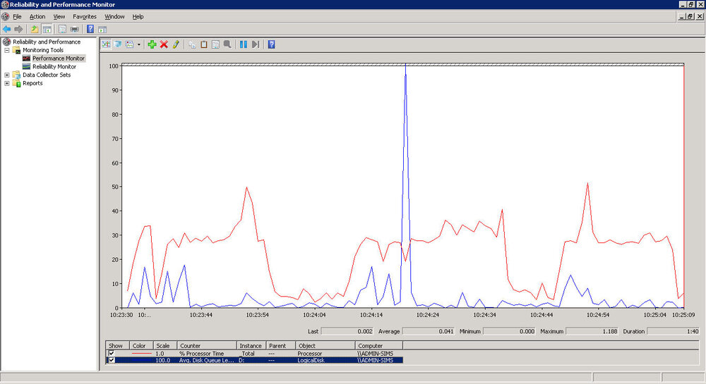

Ah, my ADQL figures may have been way off. The perfmon scale is a little difficult to understand, but it seems like the values are all fractional and typically very small.
Here are a couple of graphs from perfmon. The first shows searches for three different years (the three different "spikes"). The second shows a whole school search, which doesn't finish within the graph. You can see the CPU loading. Curiously the year searches don't max out the processor, but still take a long time relatively speaking.
