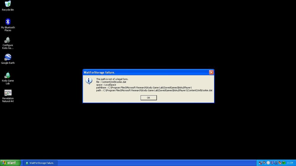

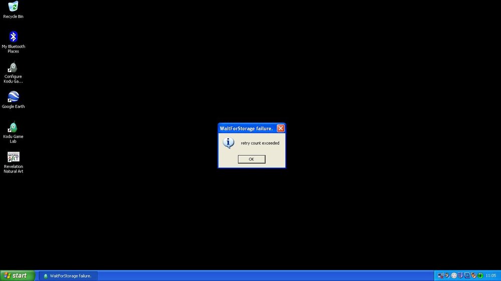

CommodoreS Posted February 3, 2012 Posted February 3, 2012 I have installed Kodu which is working fine for administrator users. However when Students use it they are shown the error shown in the first picture, which repeats until eventually the error in the second picture is shown. The software then seems to load OK, but I am still concerned about these error messages.
Jay_Jay Posted February 3, 2012 Posted February 3, 2012 We installed Kodu the other day and not seen this error message yet, have you edited the config at all ?
Steve21 Posted February 3, 2012 Posted February 3, 2012 Saved Games/Boku/Player 1 should be redirected to user appdata (At least ours is), So I'm assuming it's whining that it can't find it as students can't access C drive? Steve
CommodoreS Posted February 5, 2012 Author Posted February 5, 2012 I have not edited the config at all. Just sent the standard MSI out to workstations. Does Saved Games/Boku/Player 1 get redirected to AppData automatically or is this a manual config? I wonder if there is also another AD setting (2003 Server) that could be set which is causing the problem.
